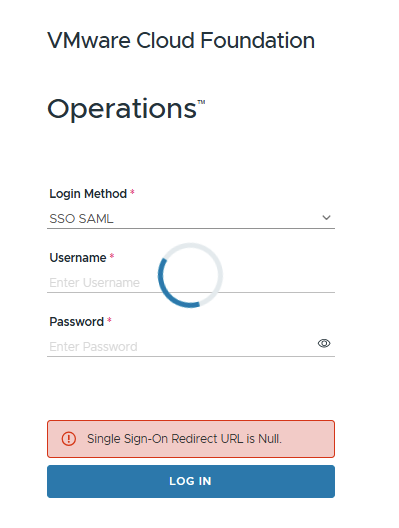

  • When attempting to log in to Ops using the SSO SAML authentication source, with the “Automatically redirect VCF Operations single sign-on URL” option disabled, the login results in an indefinite loading spinner and with the error “Single Sign-On Redirect URL is Null.”

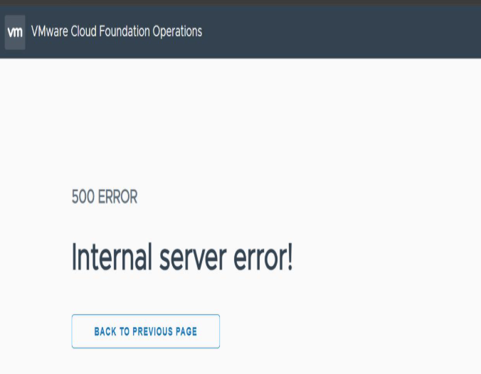

  • With the “Automatically redirect VCF Operations single sign-on URL” option enabled, the login fails with "500 ERROR: Internal server error!"
