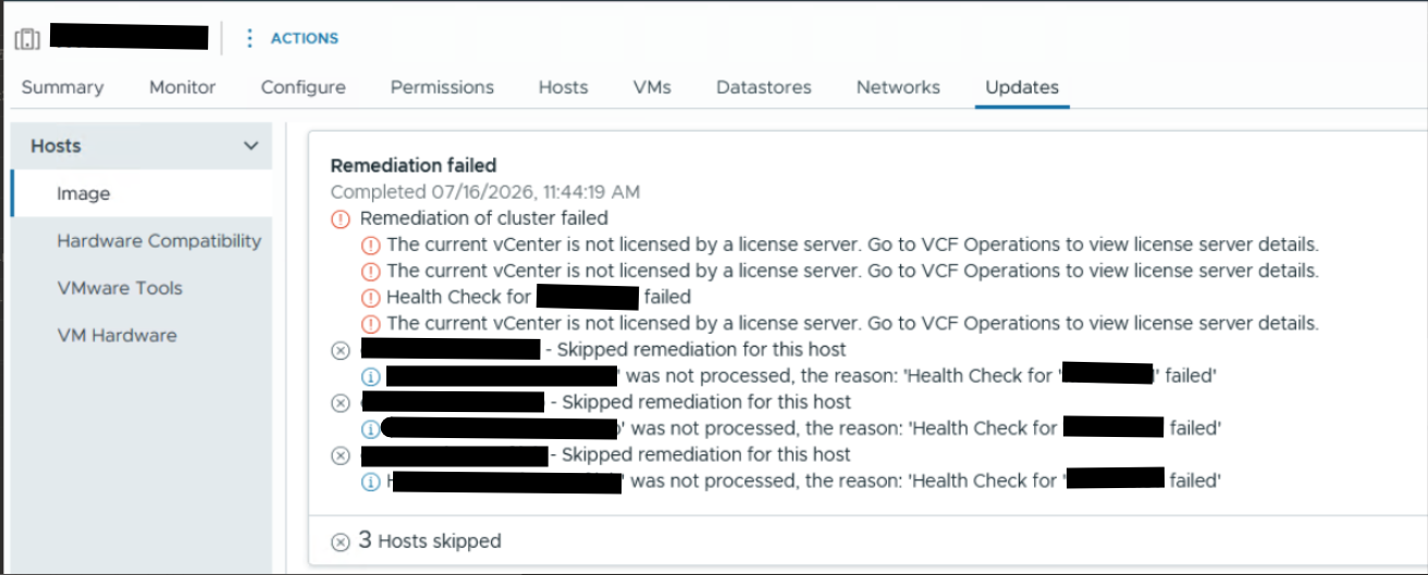

  • During a VMware Cloud Foundation (VCF) 9.1 upgrade, the process fails with the following error displayed in the vCenter Server UI under Cluster > Updates: "The current vCenter is not licensed by a license server. Go to VCF Operations to view license server details".
