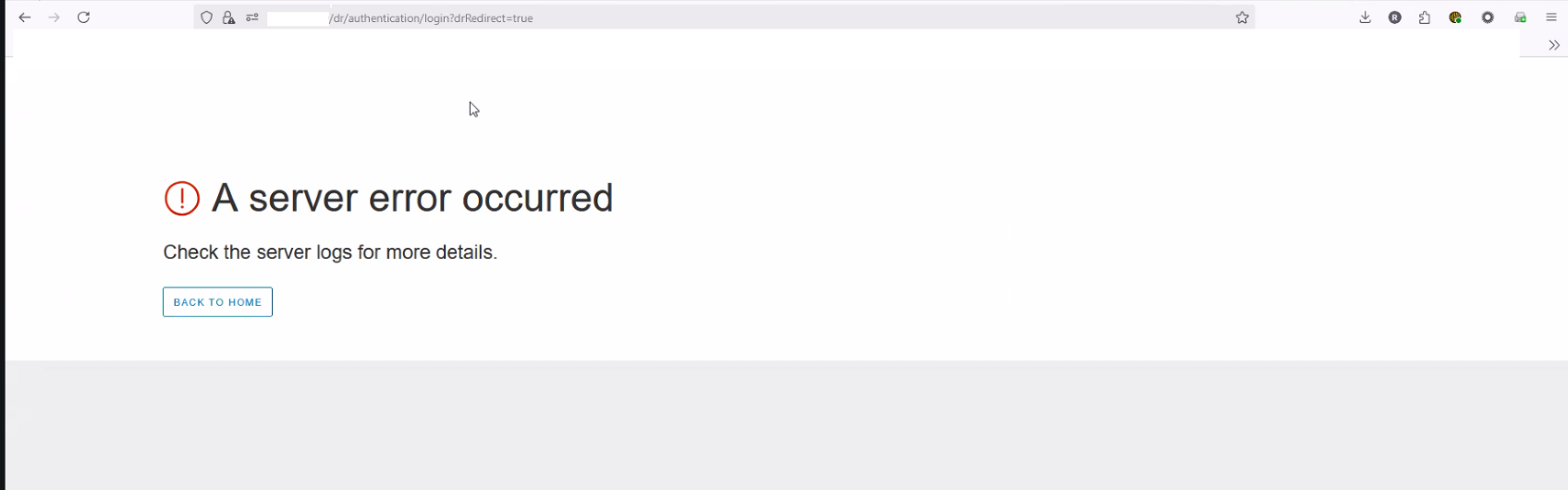

  • The following issue occurs while attempting to access the VMware Live Recovery UI via a web browser:
    "A server error occurred"
