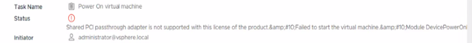

  • Attempts to power on a virtual machine in the environment fail. With error "Shared PCI passthrough adapter is not supported with this license of the product"
  • The vSphere Client task console displays the following error: Shared PCI passthrough adapter is not supported with this license of the product.
  • The ESXi host is utilizing a vSphere Standard license.
  • The virtual machine logging (vmware.log) indicates a failure in the Module DevicePowerOn process

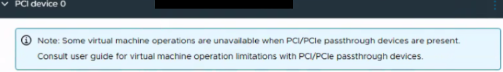

  • Modify Virtual Machine Hardware: If a license upgrade is not feasible, remove the unsupported hardware from the virtual machine:
    1. Right-click the virtual machine in the vSphere Client and select Edit Settings.
    2. Locate the PCI Device configured for shared access (e.g., NVIDIA vGPU).
    3. Click the X to remove the device and select OK to save changes.
  • Alternative Configuration: If hardware passthrough is required while utilizing a vSphere Standard license, configure the physical device as a dedicated DirectPath I/O (Standard PCI Passthrough) device instead of a Shared PCI adapter, provided the hardware supports this configuration.
