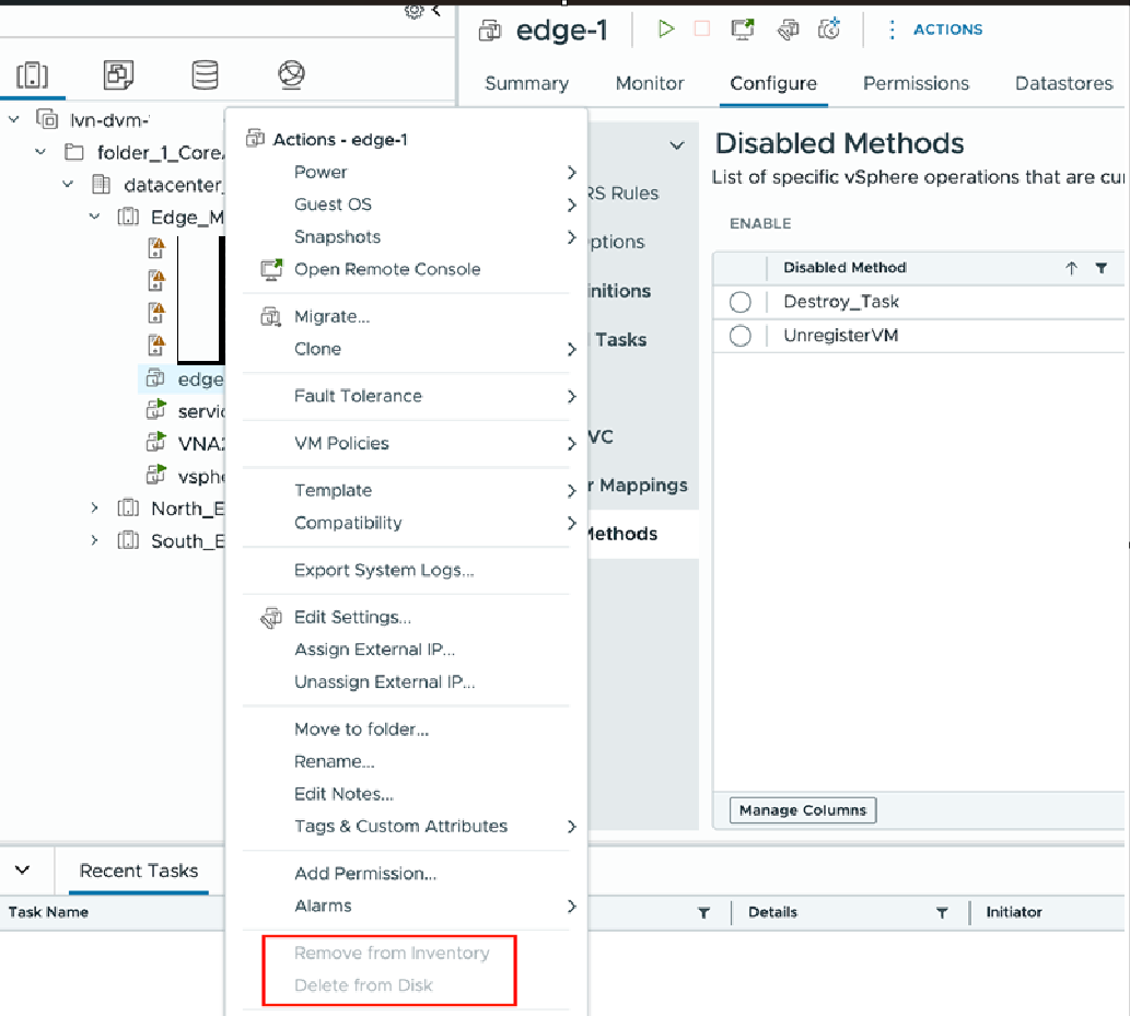

The VM cannot be deleted because the Destroy_Task and UnregisterVM methods are disabled under Actions on the Edge VM in vCenter.

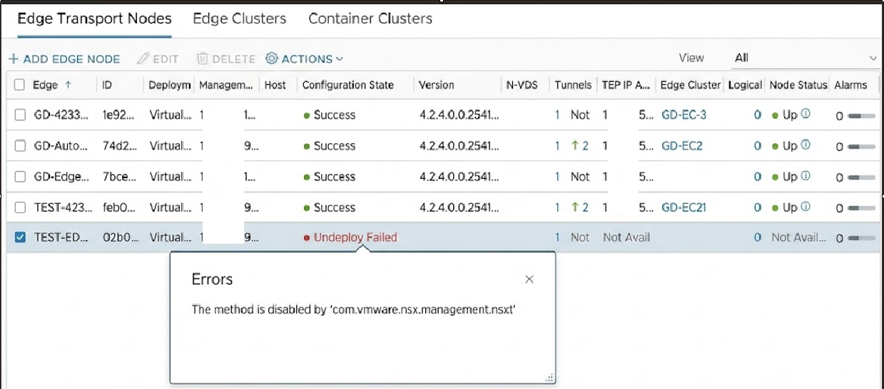

During a rolling upgrade, redeploying an upgraded Edge node fails with: Ovf deploy for vm <name> failed on vc <ip> : VC operation failed : The name '<vm-name>' already exists.
During a rolling upgrade, deleting an upgraded Edge node fails with: The method is disabled by 'com.vmware.nsx.management.nsxt'

Starting in NSX 4.2.4 / VCF 9.1, NSX deliberately disables the Destroy_Task and UnregisterVM methods on Edge VM in vCenter, to prevent an Edge VM from being deleted or unregistered outside of NSX. If it were removed directly from vCenter, NSX would be left with a stale Edge VM reference on its side with no way to reconcile it.

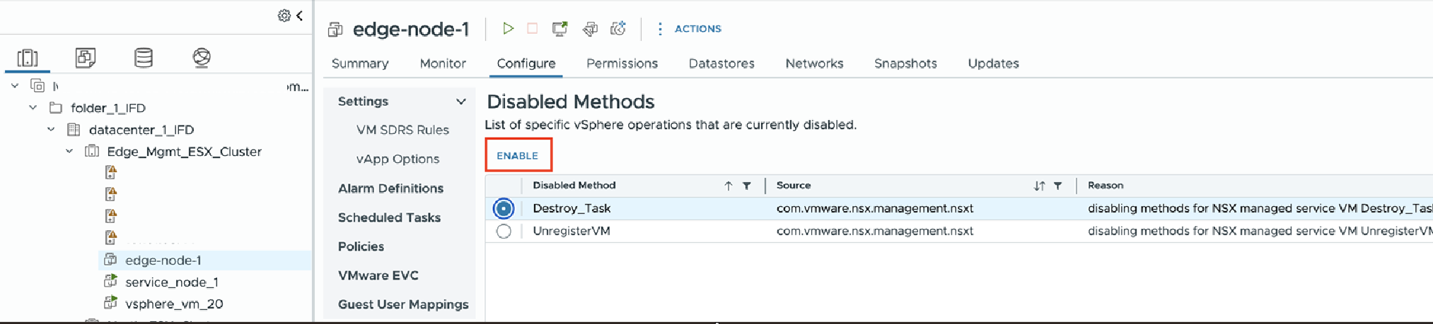

Log in to vCenter and locate the target Edge VM in the inventory.
Select the Edge VM and make sure it is powered off, go to the Configure tab, then Disabled Methods.
Select Destroy_Task and click Enable. Repeat this step for UnregisterVM." This re-enables "Remove from Inventory" and "Delete from Disk" for that VM.
