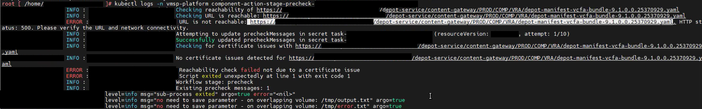

  • Workflow pod logs (can be checked using the kubectl get pods -A | grep precheck then kubectl logs -n vmsp-platform component-action-stage-precheck-<id of the pod that is in Error state> commands) show "URL is not reachable: <URL>. HTTP status: 500. Please verify the URL and network connectivity" even though the URL is reachable.

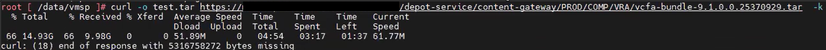

  • Testing the curl -o test.tar <URL captured from the above error> -k command fails exactly after downloading 9.96 GB with curl: (18) end of response with <5GB in bytes> bytes missing error.
  • The connection terminates consistently once the data transfer reaches 10GB.
