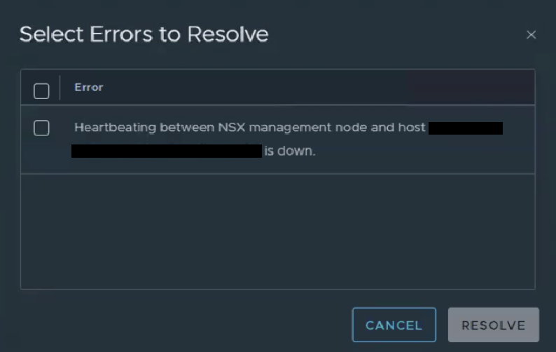

  1. Log in to the NSX Manager UI and navigate to System > Fabric > Nodes > Host Transport Nodes.
  2. Identify the host displaying the UNKNOWN status or heartbeat alarm.
  3. Click the Configuration Failed or Node Message link for that host.
  4. Select the checkbox for the heartbeat error and click Resolve.
  5. Verify the host status transitions to Success and the node status displays as Up.
  6. Re-run the NSX upgrade pre-checks.
