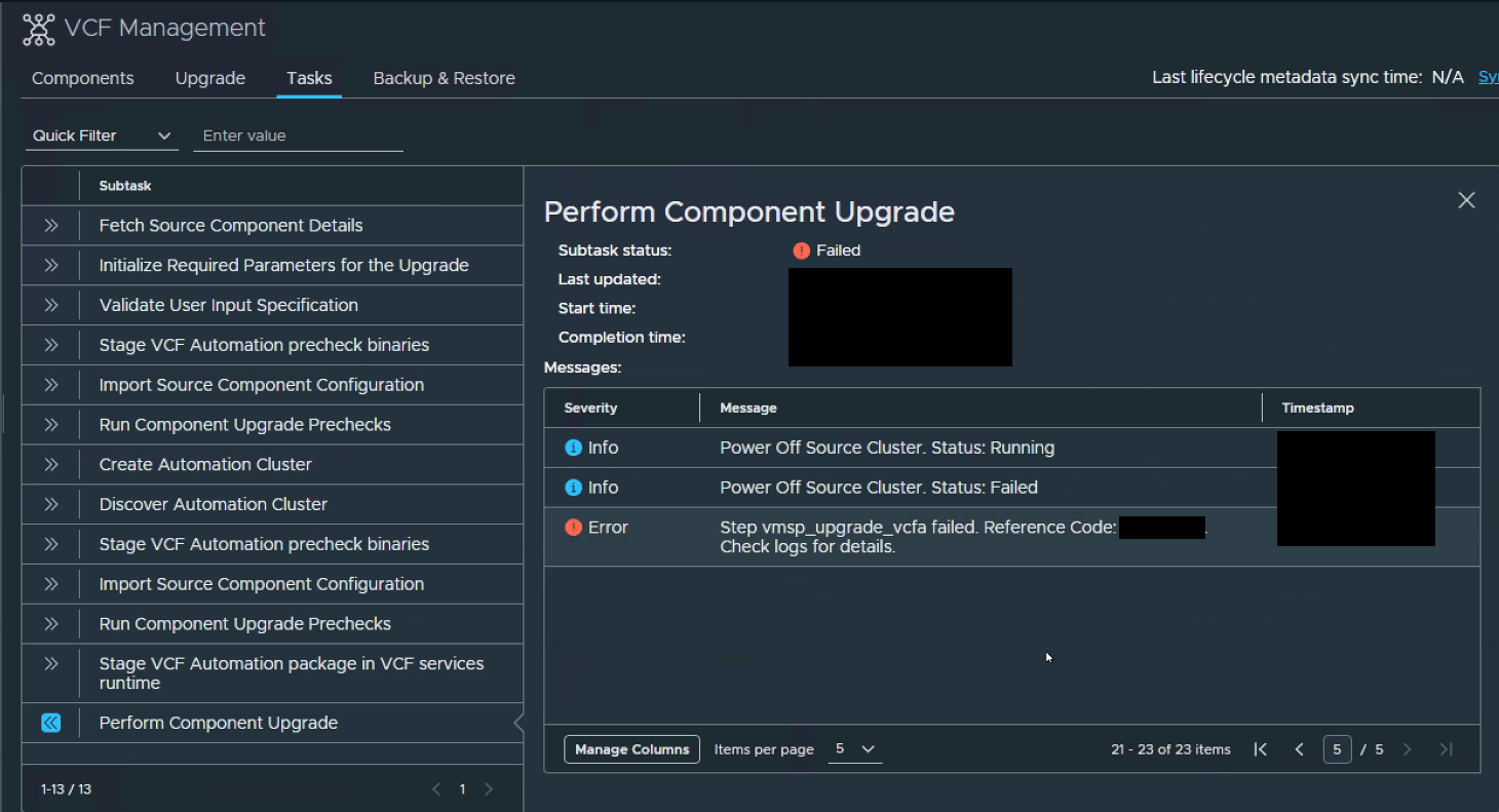

VCF Automation upgrade fails during the component upgrade stage after successfully completing the upgrade pre-checks. You see the following error messages during the failure:
Info : Power Off Source Cluster. Status: Failed
Error : Step vmsp_upgrade_vcfa failed.
VCF Automation 9.0 / 9.1

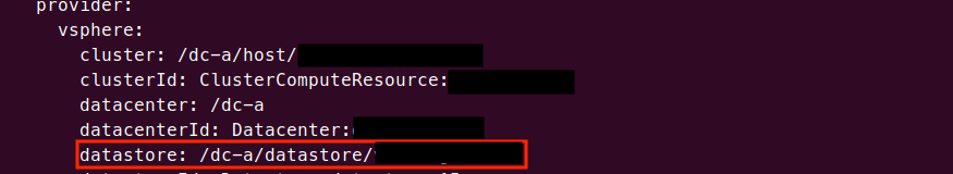

Check the datastore path in the VCFA 9.0 configuration: Log in to the VCFA appliance using SSH as root and run the following command to retrieve the configured datastore path:
k get pd vmsp-platform -n vmsp-platform -o yaml
spec:
values:
provider:
vsphere:
datastore:

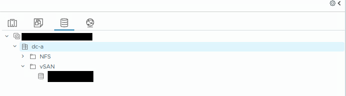

Check the actual datastore path in vSphere Client: Log in to the vCenter Server using the vSphere Client and verify the current datastore location of the VCFA VMs. (Note: The configuration from Step 1 must exactly match the path seen in vCenter.)
