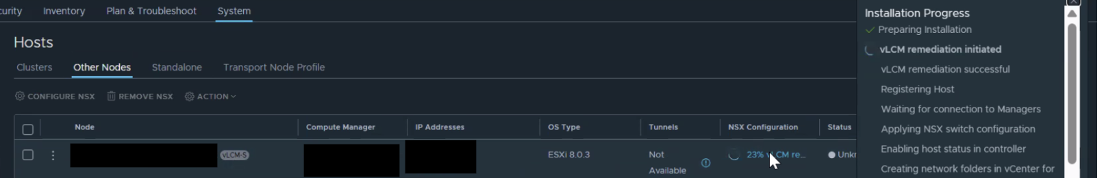

  • The host preparation process within vSphere Lifecycle Manager (vLCM) fails at 23% due to a UUID mismatch between the host's local configuration and the NSX Manager.
  • CLI validation with the command get node-uuid on the transport node post invoking nsxcli shows a mismatch between the Host's local UUID and the UUID in the NSX Manager UI (Fabric > Hosts):

  • Connectivity between the Host and both the Controller and Manager is down.
  • While searching the host on NSX elastic search we can see the stale segment ports are visible in NSX elastic search
VMware NSX
  • A discrepancy between the local host UUID and the NSX Manager UUID was caused by stale segment ports remaining connected to the NSX host.
  • These stale ports triggered the UUID mismatch between the host and the NSX Manager.
  • This discrepancy is causing connectivity issues with both the controller and the manager on the host.
