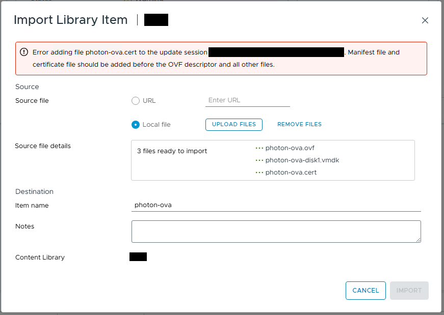

When uploading an OVF or OVA template to the VMware Content Library—either via the vSphere Client (GUI) or the SDK/API—the task failed with the following error.
- vSphere Client
- /var/log/vmware/content-library/cls.log

vCenter Server 8.0U3 and later
This error occurs when an OVF package includes a Certificate (.cert) file but the Manifest (.mf) file is missing from the upload or is uploaded out of sequence.
The Content Library service has a validation policy for signed templates:
Starting in vCenter Server 8.0U3, the Content Library enforces a stricter validation policy for signed templates. If a Certificate (.cert) file is included without the corresponding Manifest (.mf) file, the service cannot verify the template's authenticity and the upload fails.
