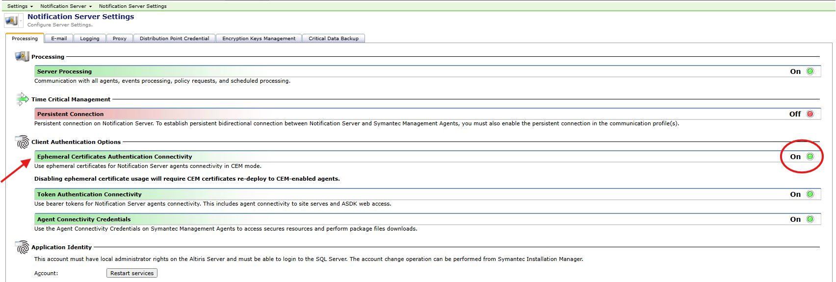

Ephemeral Certificates Authentication Connectivity was enabled after upgrading. This policy is located in Settings > Notification Server > Notification Server Settings

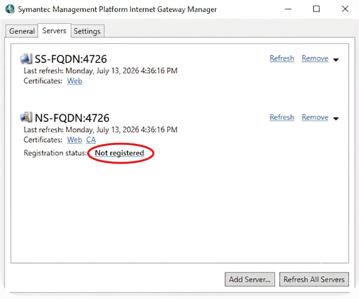

CEM Internet Gateway/s are not registered to the Notification Server.
The 'Servers' tab of the Symantec Management Platform Internet Gateway Manager shows connected Site Servers and Notification Servers. The 'Registration status:' under the NS shows: 'Not registered'
The 'Settings' tab of the Internet Gateway Manager shows a new 'Ephemeral Certificate Authentication' section and 'Allow ephemeral certificates authentication' is enabled.
ITMS 8.8.1 introduces support for a new type of certificates known as Ephemeral Certificates. This new type of certificate can streamline the process of generating and managing CEM client certificates. Consistent with the industry trend, ephemeral certificates make it easier for ITMS administrators to use CEM client certificates with a short duration.
If the Internet Gateway is not registered with the Notification Server, it rejects all ephemeral certificates from connecting agents. Agents can still connect using permanent certificates in this state. When ephemeral certificate connectivity is enabled, the CEM agent installation package will be built with ephemeral certificate authentication.
See KB Cloud-enabled Agents Access Troubleshooting page: usage and CEM connection reporting (ITMS 8.8.1)
Register the Notification Server on all configured Internet Gateways.
