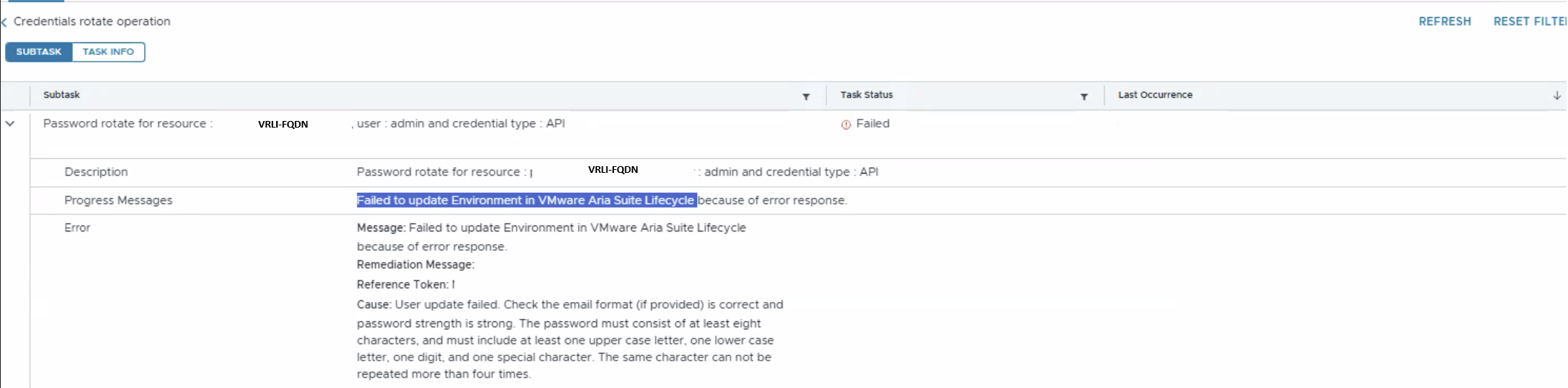

  • Initiating a Rotate passwords task towards Aria Operations for Logs "admin" account the subtask fails with below error:

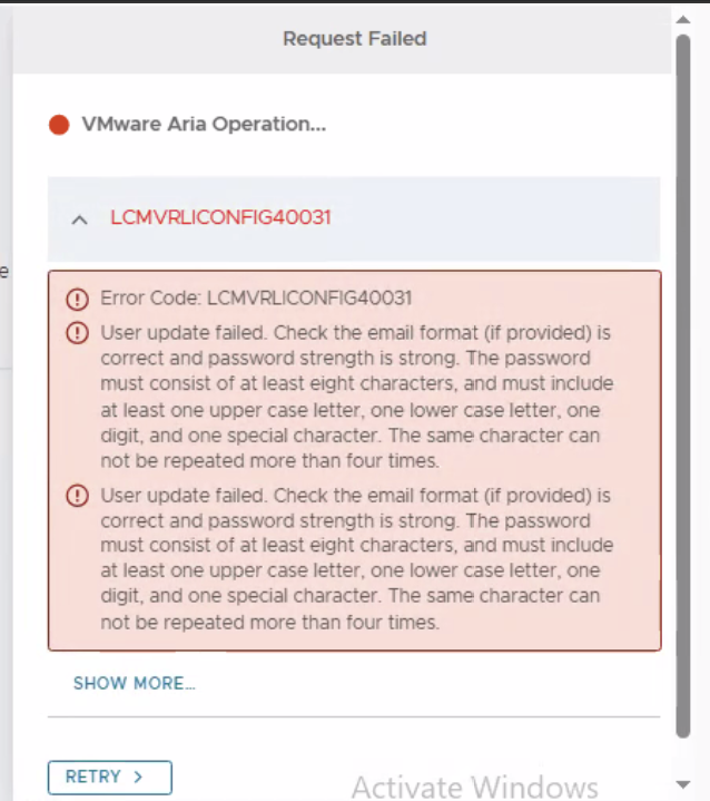

  • Within the Aria Suite Lifecycle Manager the "Update Password" task towards the Aria Operations for Logs "admin" account fails with Error Code: LCMVRLICONFIG40031
    The "RETRY" failed even after entering a password that meets all complexity criteria.
