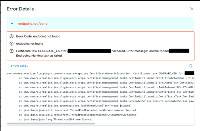

Generate Certificate Signing Request - Internal fails instantly with
Error Code: endpoint.not.found
endpoint.not.found
Certificate task GENERATE_CSR for <COMPONENT FQDN> has failed.
Error message: Unable to find <COMPONENT TYPE> End point.
com.vmware.vrealize.lcm.plugin.common.vrops.exceptions.CertificateGenericException: Certificate task GENERATE_CSR for <COMPONENT FQDN> has failed.
Error message: Unable to find <COMPONENT TYPE End point. Marking task as failed at com.vmware.vrealize.lcm.plugin.core.vrops.certificatemanagement.tasks.CertTaskUtil.handleCertificateTaskFailure(CertTaskUtil.java:177) at com.vmware.vrealize.lcm.plugin.core.vrops.certificatemanagement.tasks.CertTaskUtil.handleTerminatedTask(CertTaskUtil.java:142) at com.vmware.vrealize.lcm.plugin.core.vrops.certificatemanagement.tasks.CertTaskUtil.monitorTaskInternal(CertTaskUtil.java:106) at com.vmware.vrealize.lcm.plugin.core.vrops.certificatemanagement.tasks.CertTaskUtil.monitorCertificateTask(CertTaskUtil.java:82) at com.vmware.vrealize.lcm.plugin.core.vrops.certificatemanagement.tasks.CertTaskUtil.monitorCertificateTask(CertTaskUtil.java:66) at com.vmware.vrealize.lcm.plugin.core.vrops.certificatemanagement.tasks.GenerateCSRTask.execute(GenerateCSRTask.java:51) at com.vmware.vrealize.lcm.automata.core.TaskThread.run(TaskThread.java:50) at java.base/java.util.concurrent.ThreadPoolExecutor.runWorker(Unknown Source) at java.base/java.util.concurrent.ThreadPoolExecutor$Worker.run(Unknown Source) at java.base/java.lang.Thread.run(Unknown Source)

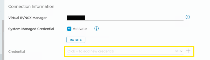

      1. Navigate to Operate > Administration > Integrations
      2. Click Account Tab
      3. Expand "VMware Cloud Foundation" instance
      4. Expand domain (Management/workload) instance
      5. Edit setting of NSXT Adapter instance [case is created for NSX but may be applied for other components]
      6. Either switch to "System Managed Credential" selected
      7. Or click on "Rotate" > "Validate Connection > "Save" if "System Managed Credential" already in use
        *Credentials highlighted below are known to cause problems - i.e. these can expire, need to be updated constantly etc.

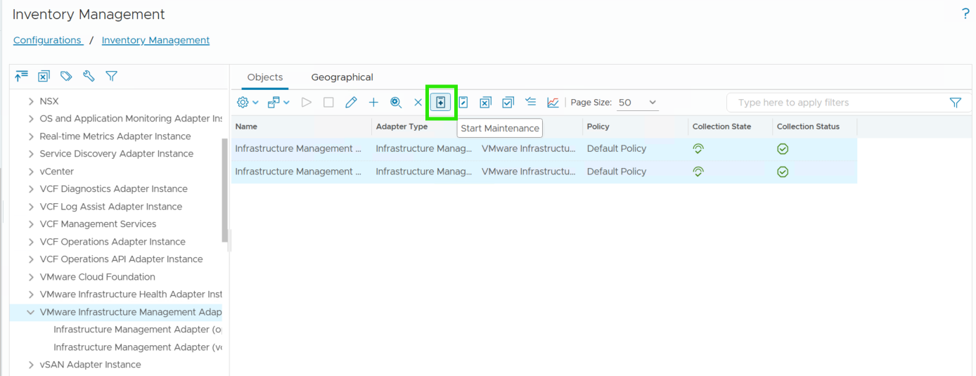

    2. To force collection Navigate to → Operate → Administration → Configuration → Inventory Management → Adapter Instances → VMware Infrastructure Management adapter instances
    3. Select all Infrastructure Management Adapter rows → Click Start Maintenance
       Select all Infrastructure Management Adapter rows → Click End Maintenance [same as above]
    4. Wait for few mins (up to 5 mins), check if Certificate Operation is successful or same endpoint not found issue is seen.
