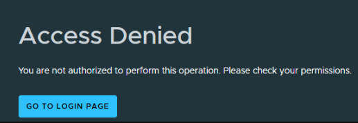

When logging into the NSX Manager UI using VMware Identity Manager (vIDM) integration, authentication fails with "Access Denied." This occurs specifically when permissions are assigned via vIDM Groups rather than individual users.
