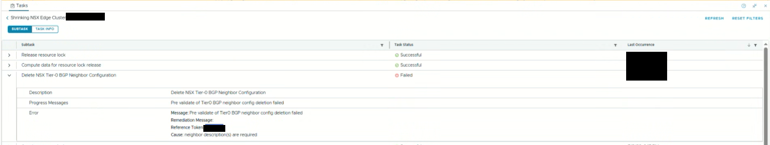

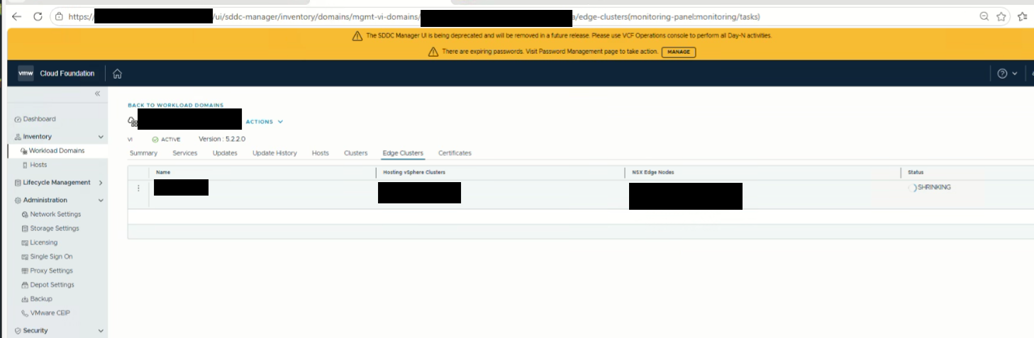

  • Shrinking task stuck at SDDC Manager for NSX edge node cluster and not progressing anywhere -
  • Failed task details -
    Delete NSX Tier-0 BGP Neighbor Configuration - Failed
    Description - Delete NSX Tier-0 BGP Neighbor Configuration
    Progress Messages  - Pre validate of Tier0 BGP neighbor config deletion failed
    Error
    Message: Pre validate of Tier0 BGP neighbor config deletion failed
    Remediation Message:
    Reference Token: #######
    Cause: neighbor description(s) are required
  • Even deleting its associative task using its ID, restarting SDDC services or even rebooting the SDDC appliance will not make any change and the Shrinking task keeps on moving.

This method updates the SDDC Manager database with an incomplete status, leaving the cluster entry in the "ACTIVATING" or "SHRINKING "state.

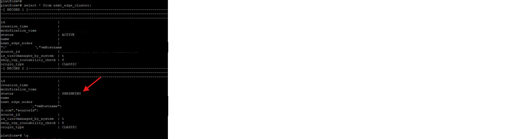

Verify the same through SDDC DB using the following commands, where s stale entry is showing with either "ACTIVATING" or "SHRINKING" status in the nsxt_edge_cluster table-
1. psql -h localhost -U postgres
2. \c platform
3. platform # select * from nsxt_edge cluster;

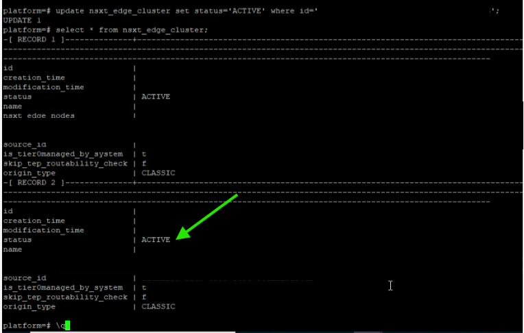

2. Find the NSXT Edge cluster table and update status from "SHINKING" or "ACTIVATING" to "ACTIVE"
platform=# update nsxt_edge_cluster set status='ACTIVE' where id='<id>';
UPDATE 1

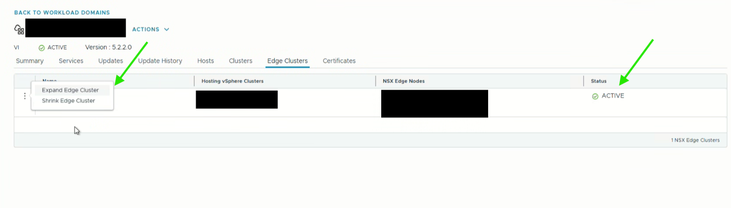

3. Check and confirm active status -
platform=# select * from nsxt_edge_cluster;
platform=# \q
4. Post that the SHIRNKING status for the NSX Edge cluster becomes ACTIVE and grayed out options are available to proceed further -
