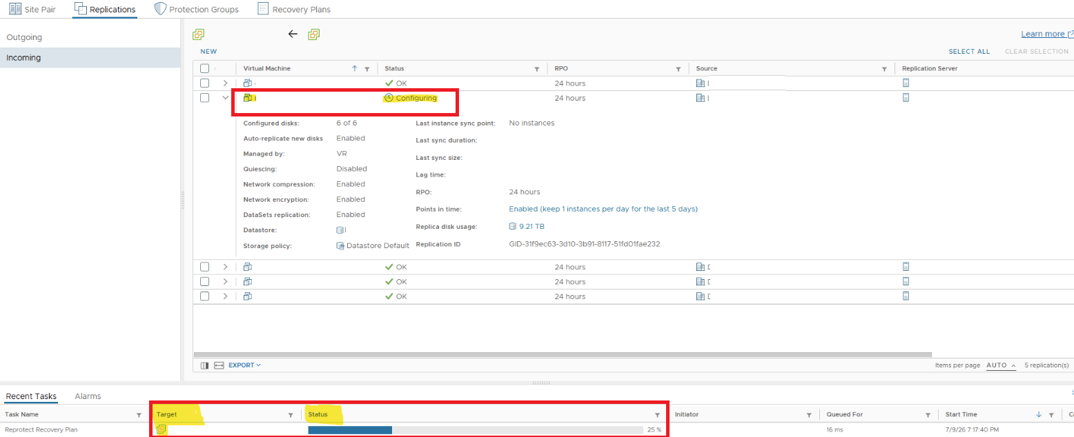

Symptoms:
  • A virtual machine reprotect task hangs at 25 percent progress and fails to complete after a successful Planned Migration.
  • The vSphere Replication Management Server (VRMS) user interface displays the following error:
"Unable to reverse replication for the virtual machine '########'. A generic error occurred in the vSphere Replication Management Server. Exception details: 'Error while searching (hms.DatastorePath) dynamicType = null, dynamicProperty = null, datastore = MoRef: type = Datastore, value = datastore-########, serverGuid = null, path = ########, fileName = ########.vmdk '."
