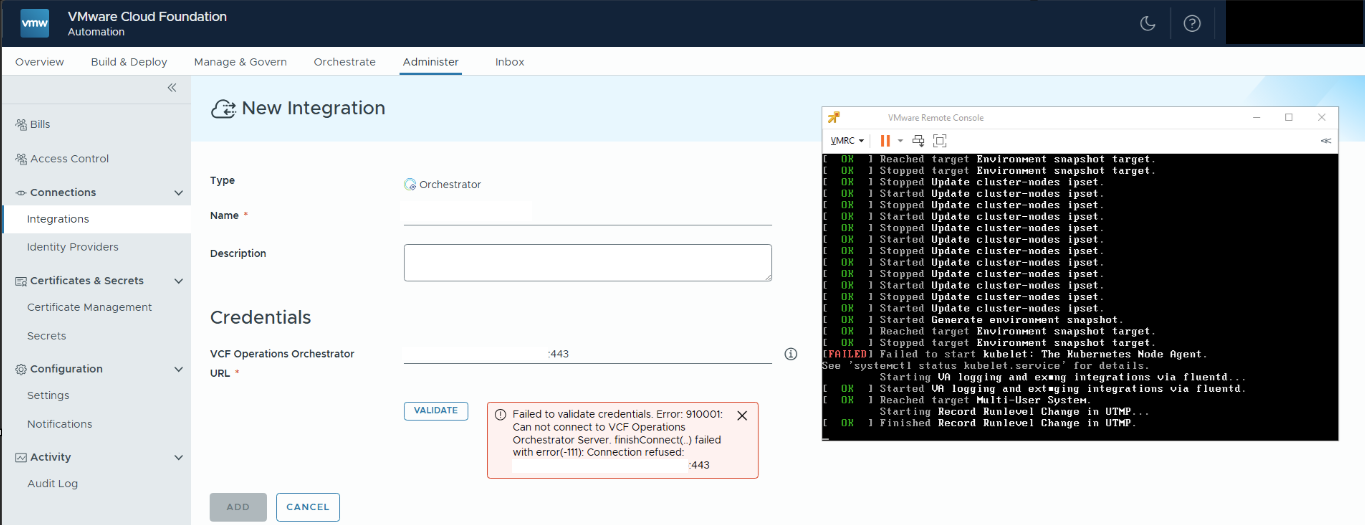

When deploying a fresh standalone VCF Operations Orchestrator 9.0.2 appliance, integration with VCF Automation fails, and the appliance becomes stuck during its initial boot cycle.
Reviewing the appliance via SSH or the vCenter Web Client console surfaces the following symptoms:
  • The guest OS boot sequence stops and displays an explicit failure: run-bootstrap.service failed.
  • Checking the local Kubernetes environment with kubectl get pods -n kube-system indicates that all three state-enforcement-cron pods are in an Error state.
  • Inspection of the pod error logs via kubectl logs <state-enforcement-cron-pod-id> -n kube-system shows:
    failed check /usr/bin/systemctl is-active run-bootstrap.service: exit code: [3], stdout: [failed]
