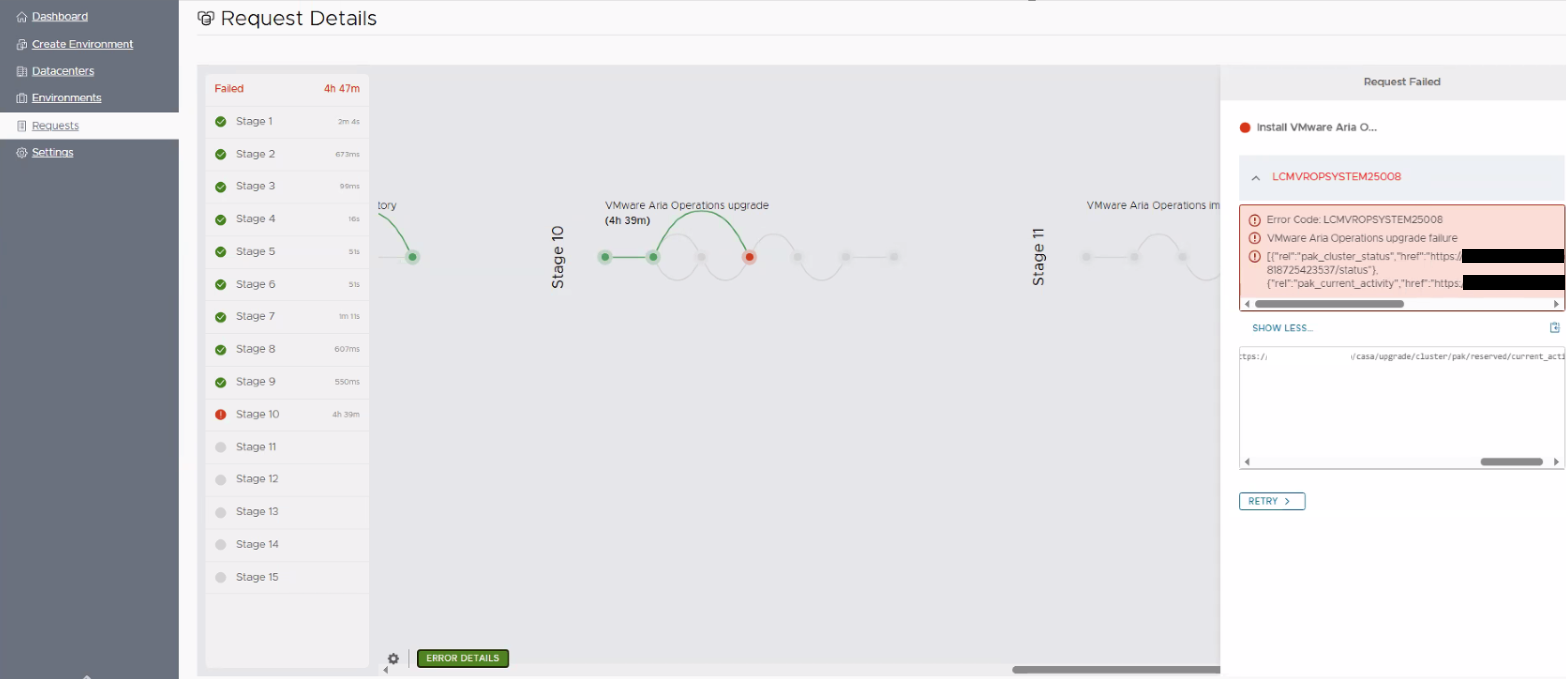

  • Aria Suite Lifecycle throws a fatal deployment error task with the below error code:
    • Error Code: LCMVROPSYSTEM25008
    • VMware Aria Operations upgrade failure
    • [{"rel":"pak_cluster_status","href":"https://FQDN/casa/upgrade/cluster/pak/vRealizeOperationsManagerEnterprise-818725423537/status"},{"rel":"pak_current_activity","href":"https://FQDN/casa/upgrade/cluster/pak/reserved/current_activity"}]

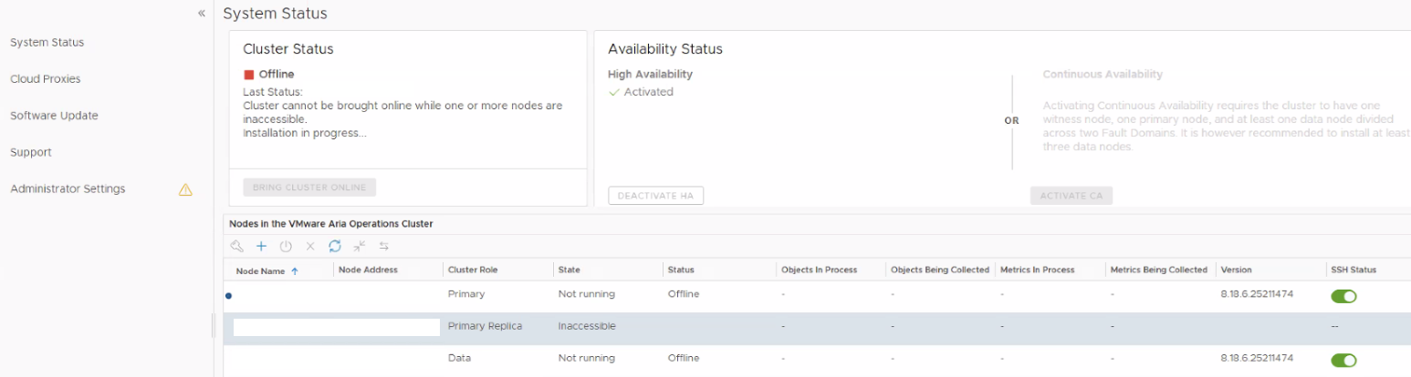

  • One or more cluster nodes (such as the Replica or Data nodes) become completely unresponsive and fail to rejoin the cluster.

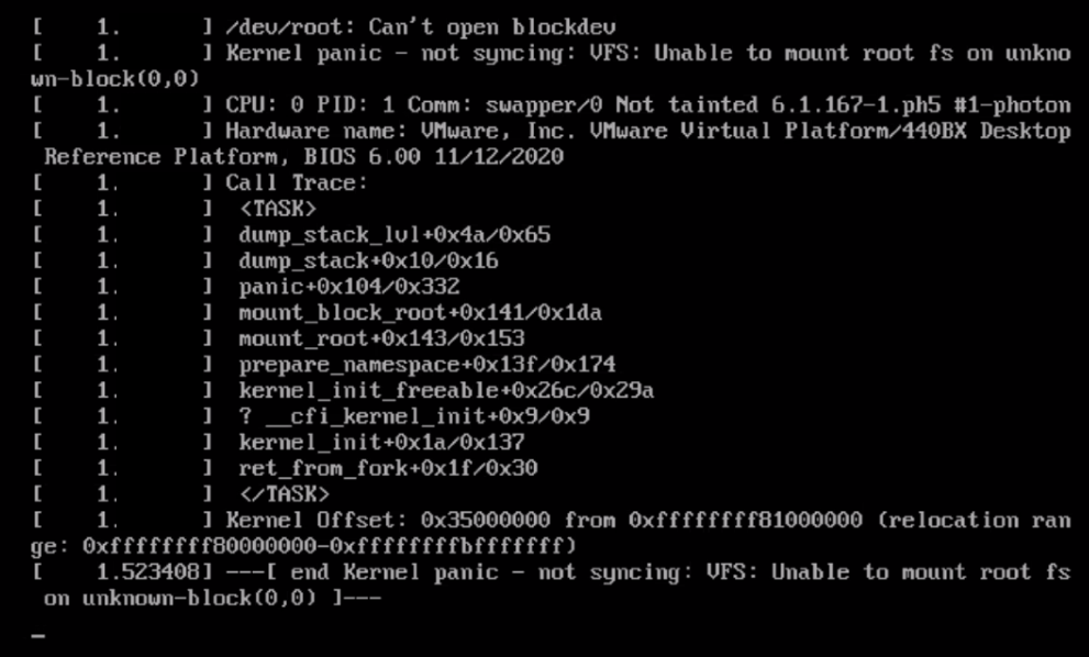

  • Direct virtual machine web console access via the vCenter Web Client reveals that the Replica (or any other node) node is completely stuck in a terminal Kernel Panic state, preventing the guest operating system from completing its boot sequence.
Aria Operations 8.18.x
This issue occurs when an individual cluster node encounters an unrecoverable operating system or storage-layer corruption during the mid-upgrade reboot cycle.
Because the Aria Operations upgrade routine uses a rolling restart strategy, the master installation daemon (InstallvROpsProductUpgradePakTask) waits for each node to reboot and establish an administrative handshake. If a node fails to boot due to an underlying OS boot loader modification, a corrupted initramfs/GRUB layout, underlying virtual disk (VMDK) block degradation, or unexpected virtual storage controller reconfigurations, the upgrade times out and aborts the entire cluster operation.
Step 1: Rollback the Cluster to Clean Baseline Snapshots
Since the operating system on the panicked node is corrupted, the environment must be reverted.
  1. Log into your managing vCenter Server web client.
  2. Gracefully shut down any remaining operational Aria Operations nodes.
  3. Revert all cluster virtual machines (Primary, Replica, Data, and associated Cloud Proxies) to their clean, pre-upgrade snapshots.
  4. Power the cluster virtual machines back on and verify that all nodes boot cleanly to an operational state.
