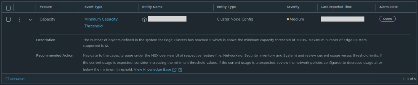

"Minimum Capacity Threshold" alarm is triggered even though the object count is below the Minimum Capacity Threshold
Article ID: 447411
VMware NSX

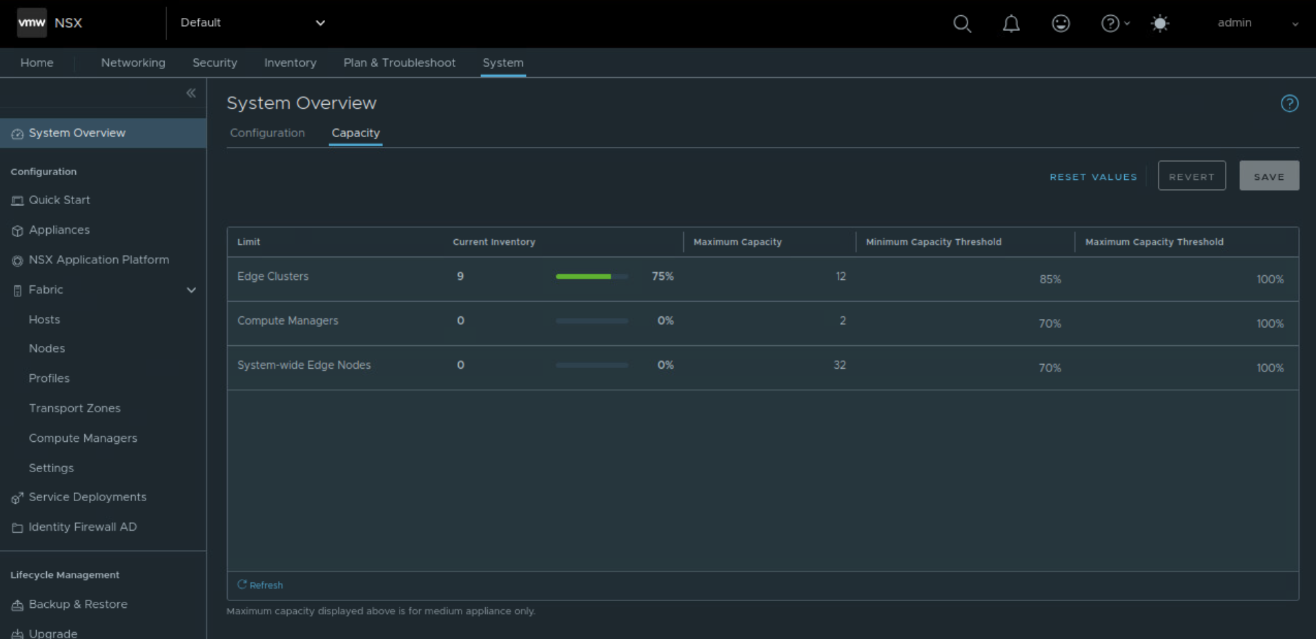

  • The setup is in the policy mode, and the Minimum Capacity Threshold was changed from System > System Overview > Capacity. In the example below, it was changed from the default 70% to 85% for Edge Clusters.
  • The "Minimum Capacity Threshold" alarm is triggered even though the Current Inventory percentage is below the Minimum Capacity Threshold. Even if the alarm is manually resolved, it triggers again immediately.

When the value is changed from System > System Overview > Capacity, it is updated in the Policy view, but the value in the Manager view is not updated, which causes the alarm to trigger.
This alarm does not impact the system and can be safely ignored.
