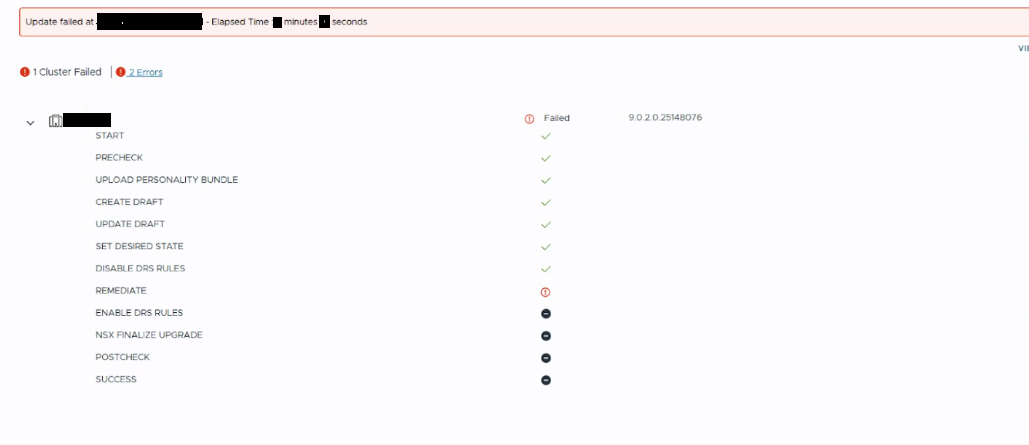

  • When performing an ESXi host upgrade (e.g., 9.0.1 to 9.0.2) within VCF Operations 9.x, the remediation task fails at the "Remediate Step."

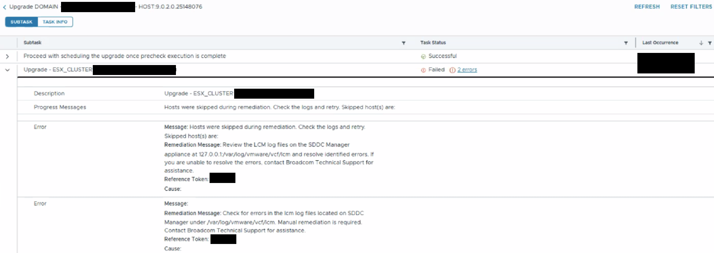

  • The failed task on VCF Operations shows below error
