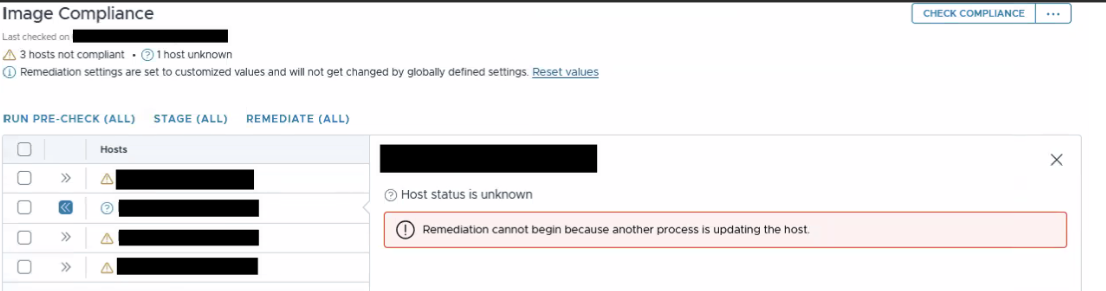

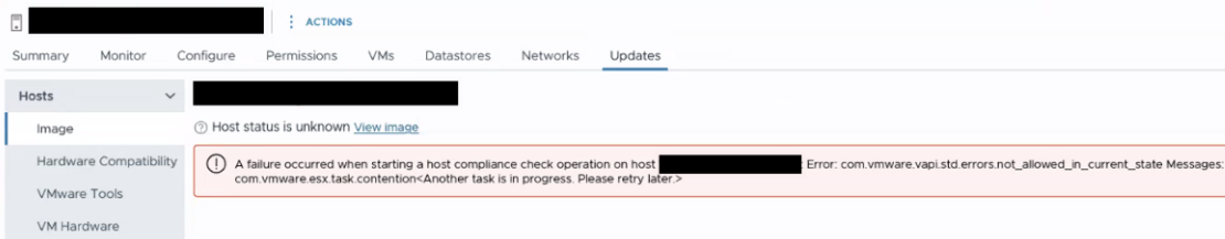

  • Post upgrade attempt of an ESX host to 9.1 using cluster image, the host successfully boots to ESX 9.1 however vSphere Lifecycle Manager fails to recognize the updated version with the compliance status for the host as "unknown" on the Updates tab of the concerned Host with an error message similar to one of the below:
    com.vmware.vapi.std.errors.not_allowed_in_current_state
    com.vmware.esx.task.contention <Another task is in progress. Please retry later.>
    Remediation cannot begin because another process is updating the host.
