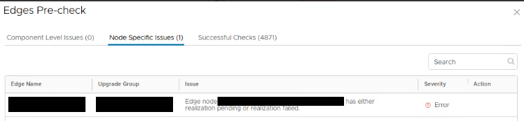

  • When running the Check Upgrade Readiness pre-checks for a VMware NSX upgrade, a failure is reported for one or more Edge Transport Nodes.
  • The following error is observed in the UI:
    • Error Code: 30265 - Edge node <UUID> has either realization pending or realization failed.
  • In the NSX UI under System > Fabric > Nodes, the Edge Node Configuration State is stuck in In Progress.
  • The following error appears in /var/log/upgrade-coordinator/upgrade-coordinator.log
    [PUC] Pre-upgrade check InspectionTaskInfo[id=edgeNodeRealizationErrorCheck,name=Check for edge node realization error in upgrade groups.] failed
    failures=[{"moduleName":"upgrade-coordinator","errorCode":30265,"errorMessage":"Edge node <UUID> has either realization pending or realization failed."}]
