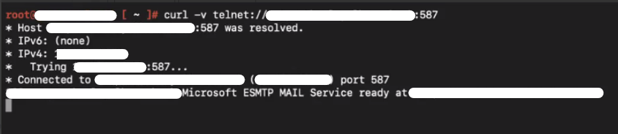

SMTP configuration from Aria Suite Lifecycle fails to send a test email. A curl test from the Aria Suite Lifecycle appliance to the SMTP server passes successfully (e.g., curl -v telnet://<smtp_server>:

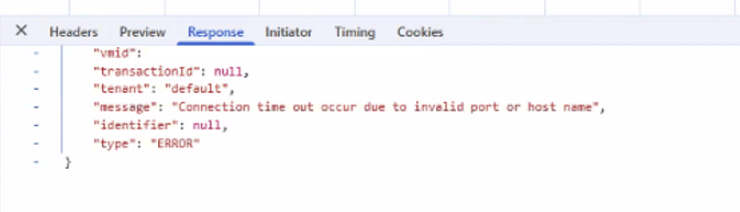

When reviewing the browser developer tools, the following error is displayed: "Connection time out occur due to invalid port or host name"
