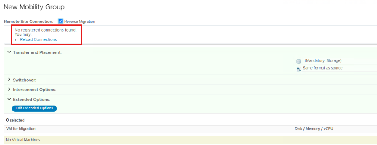

When attempting to create a new Mobility Group for VM migration in VMware HCX, the migration wizard fails to populate site inventory or load connections.
  • The migration wizard UI explicitly displays the messages "No registered connections found" and "Reload Connections".
  • Unable to create new Mobility Groups.
  • Site inventory fails to load

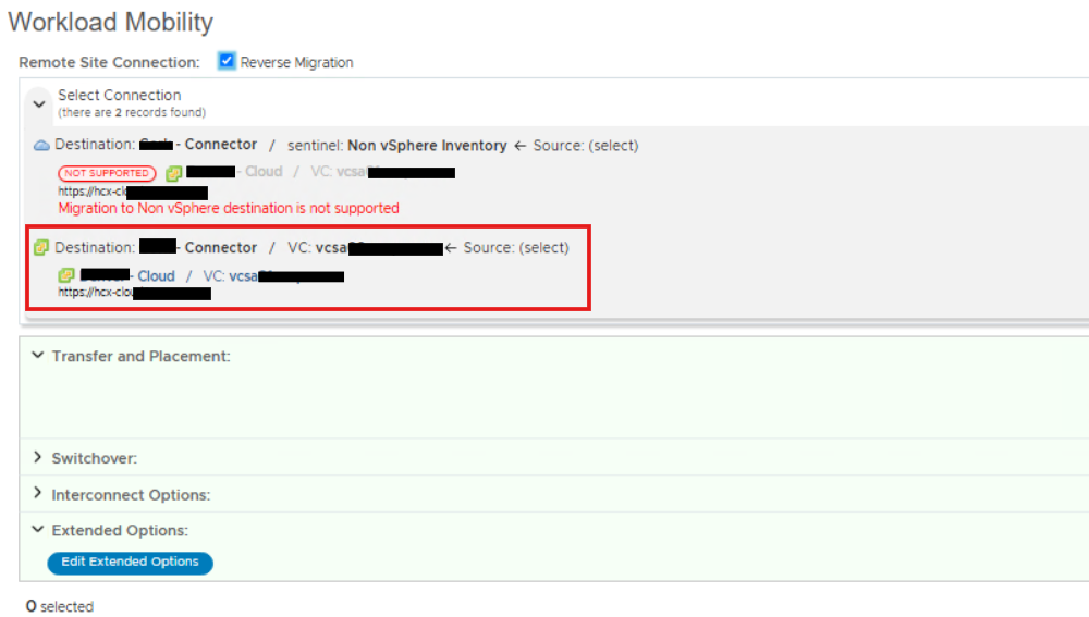

  2. Perform Reverse Migration:
    • Login to Source HCX UI, follow the Migration wizard, select the direction as Reverse Migration.
    • Example :
      • If you have Destination HCX Cloud Manager (e.g., Cloud Manager 02) and need to move a VM back to the Source (e.g., Cloud Manager 01), you must use the Reverse Migration feature from Source HCX Manager UI (e.g., Cloud Manager 01).
