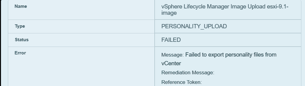

Error: Failed to export personality files from vCenter during Extract Cluster Image task
Article ID: 447144
VMware vSphere ESXi VCF Operations
  • While importing the images to SDDC's Lifecycle Manager from vCenter , Extract Cluster Image task fails with an  error "Failed to export personality files from vCenter"
