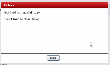

When attempting to check the oi_connector probe configuration, the following error message was displayed:
Failure
NASS url is unavailable. :0
Click Close to close dialog.
