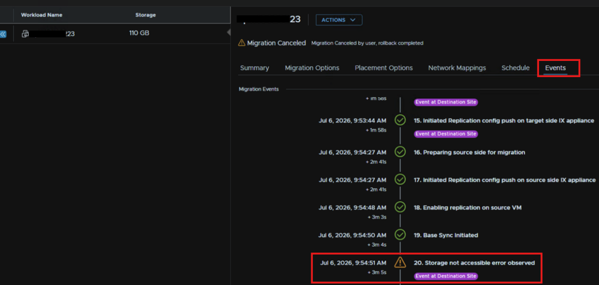

  • HCX Bulk or RAV migration fails with the following error in the HCX migration UI: "Storage not accessible error observed"

The migration stalls because TCP port 443 communication between the HCX Interconnect (IX) appliance and the target ESXi host is blocked, preventing the Host-Based Replication (HBR) server from successfully accessing the datastore.
  • Verify the network firewall rules and routing between the HCX Interconnect (IX) appliance and the target ESXi hosts.
  • Ensure that TCP port 443 is allowed from HCX-IX to the ESXi.
  • Once the port is unblocked, retry or resume the HCX RAV or Bulk migration.

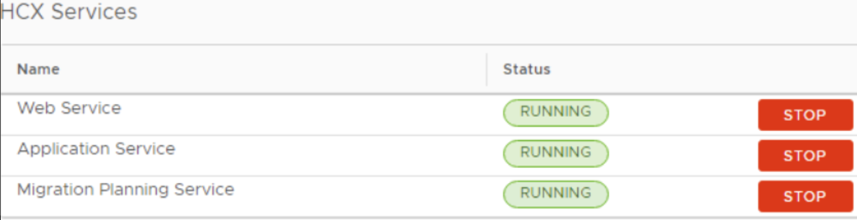

  • As a temporary measure, the replication service can be moved to the other management network if that path is unrestricted. A restart of HCX services is required after this change to ensure the IX appliance refreshes its connection path.
