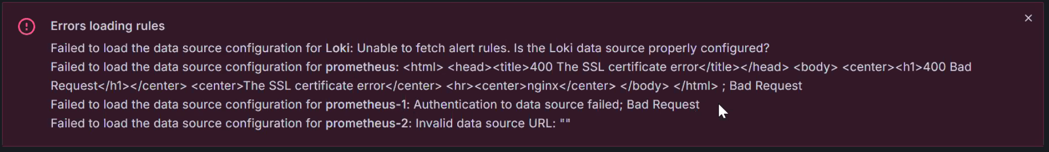

When trying to load alert rules in Grafana UI it throws:
Errors loading rules
Failed to load the data source configuration for Loki: Unable to fetch alert rules. Is the Loki data source properly configured?
Failed to load the data source configuration for prometheus-1: Authentication to data source failed; Bad Request
Failed to load the data source configuration for prometheus-2: Invalid data source URL: ""
Sample screenshot:
