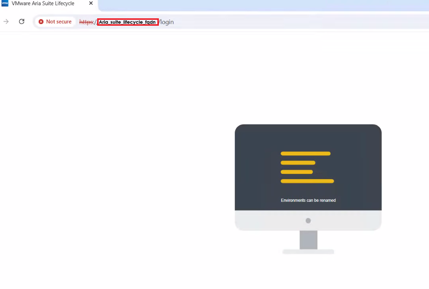

  • Aria Suite Lifecycle UI fails to load the UI when patching Aria Suite Lifecycle as per KB426230.
  • The UI prompts the service initialization screen and is indefinitely stuck on the same.

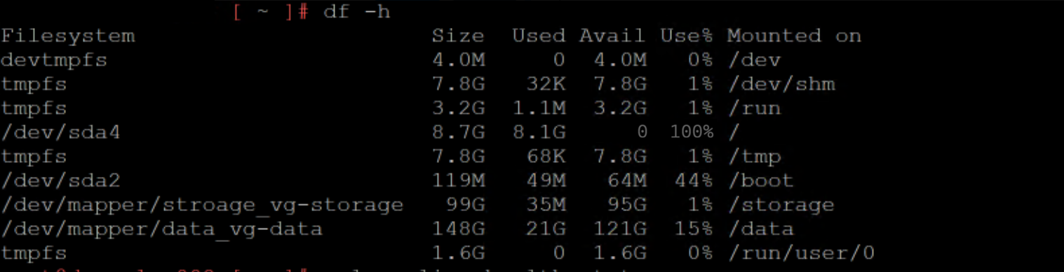

  • The df -h command shows the /dev/sda4 partition to be at/ nearing 100% utilization.
  • Aria Suite Lifecycle 8.18
  • This issue is caused when the /dev/sda4 partition hits at 100% utilization mid patching, causing failures when attempting to log or load service packages to initialize the services.
