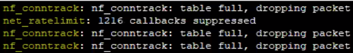

The root cause is the exhaustion of the Linux kernel's connection tracking table (nf_conntrack).
The nf_conntrack module tracks all active network connections traversing the Gorouter. When the number of concurrent connections exceeds the maximum limit configured in the kernel (nf_conntrack_max), the kernel begins aggressively dropping new packets.
Because packets are dropped at the kernel level:

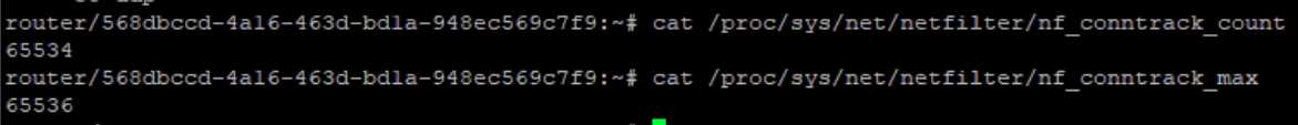

During troubleshooting, it was observed that the concurrent connections on the Gorouters were rapidly reaching ~55,000 to 60,000, hitting the maximum threshold allowed for a VM with 4GB of RAM.

To monitor the current connection tracking usage and limits on a Linux VM, you can run the following commands:
sudo sysctl net.netfilter.nf_conntrack_countsudo sysctl net.netfilter.nf_conntrack_max
