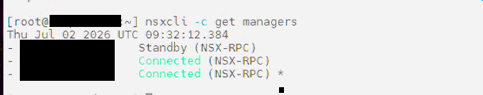

  • Executing the nsxcli -c get managers command on the affected ESXi host shows one of the NSX Managers in a "Standby" state.

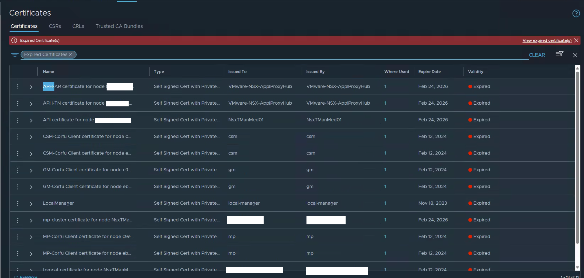

The Appliance Proxy Hub (APH) and LocalManager certificates on the NSX-T Manager have expired. This expiration breaks the Remote Procedure Call (RPC) trust and communication framework between the NSX Manager and the ESXi host transport node.
