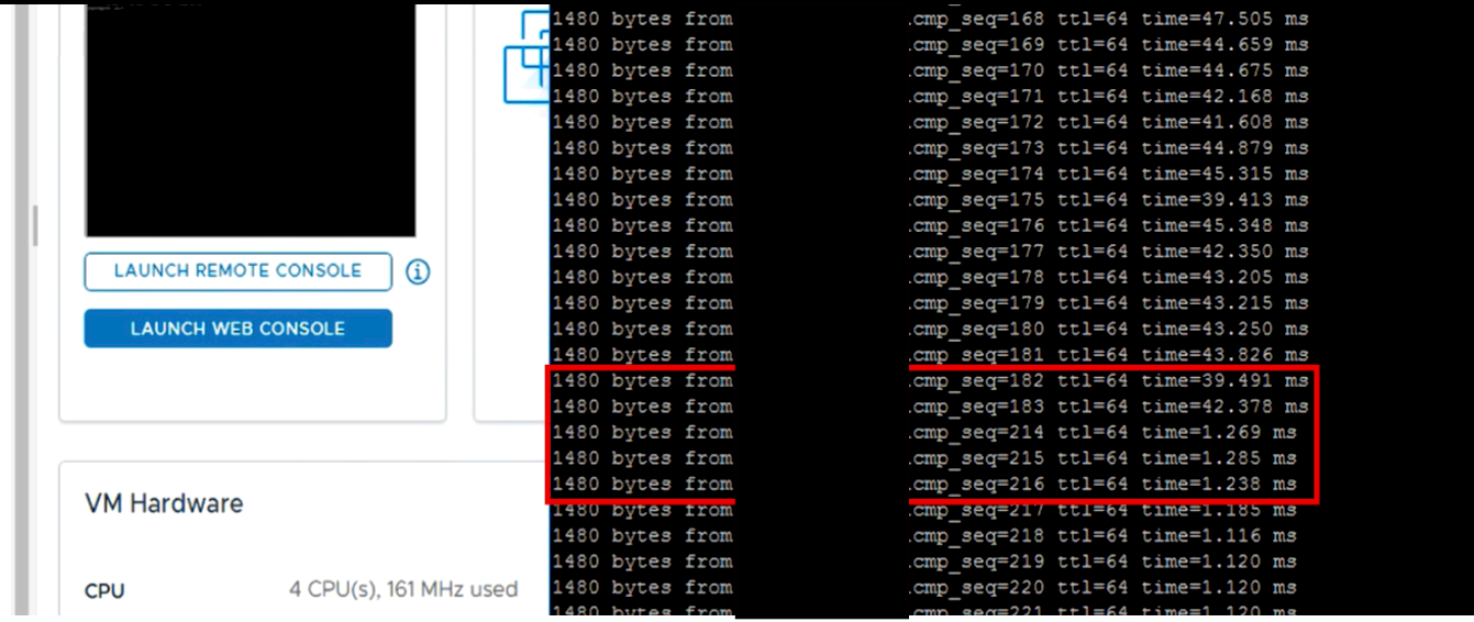

Continuous vmkping sessions between the vMotion VMkernel interfaces show immediate ICMP packet drops the moment the vMotion task initiates.
