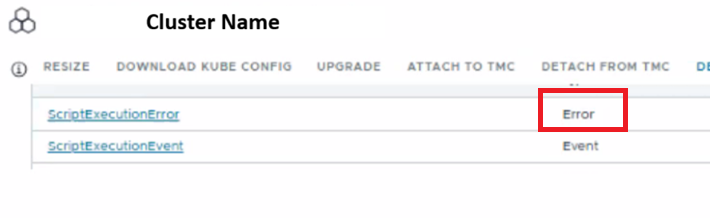

Deploying the VMware Cloud Director Container Service Extension (CSE) in an air-gapped environment, fails with "scriptexecutionerror".
In the VMware Cloud Director Events, the failure is accompanied by a "Error" for the task "scriptexecutionerror"
