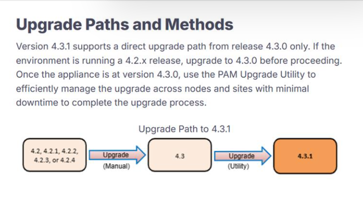

You question about if is possible to run in 4.3 the old  manual upgrade instead of utility upgrade as shown in this image
The only way to upgrade cluster nodes individually is to take them out of the cluster and upgrade them as standalone nodes. This would require to take care of any scheduled jobs, making sure none of them runs on a node that is out of the cluster.
