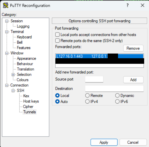

4. Set up an SSH Tunnel (if applicable) If you are working via a remote server using PuTTY, configure a local tunnel. Ensure you listen on port 443 of your local Windows system so you can access the tunnel using the standard HTTPS default port. Your connection flow looks like this:
        127.16.0.1:443SSH-TUNNEL127.0.0.1:####KUBECTL-PORT-FORWARDssp-router:8095
