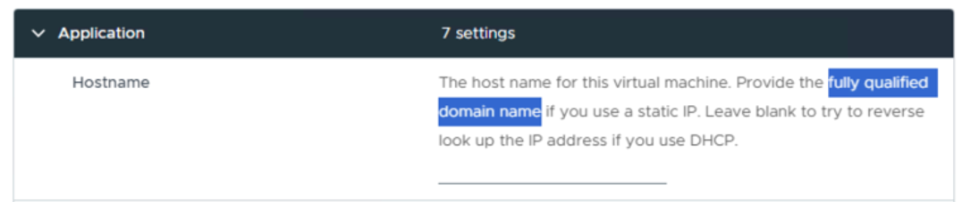

This issue occurs when a short hostname (e.g., o11n) is entered instead of a Fully Qualified Domain Name (FQDN) (e.g., o11n.example.com) during the OVA/OVF deployment wizard.
To resolve this issue, delete the failed appliance and redeploy.
  1. Delete the failed deployment instance from the inventory.
  2. Initiate a new deployment via the OVF deployment wizard.
  3. Ensure that the Hostname parameter is configured with a valid, fully qualified domain name (e.g., o11n.example.com).
