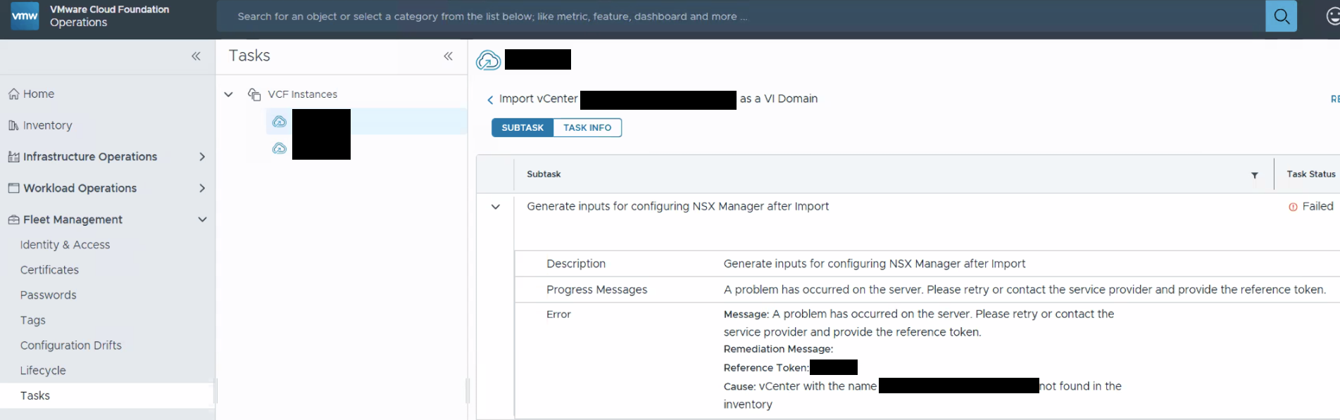

  • The Tasks under VCF Ops  Manager user interface displays a failure on the following task:
    Task Name: Generate inputs for configuring NSX Manager after Import
    Status: Failed
    Error Message: Message: A problem has occurred on the server. Please retry or contact the service provider and provide the reference token.
    Reference Token: ######
    Underlying Cause Listed in UI: Cause: vCenter with the name <vCenter-fqdn> not found in the inventory

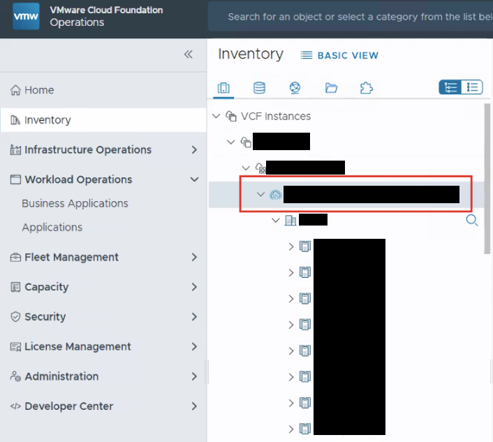

  • Under the VCF Ops Inventory, the vCenter and other components are visible.

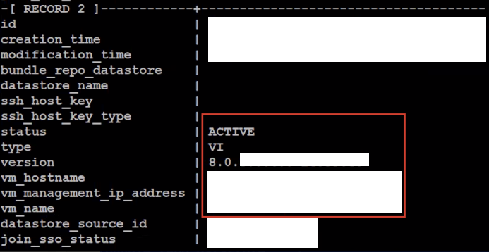

  • Checking the status of the vCenter and Domains in the SDDC DB are all in ACTIVE state, which is as follows:
