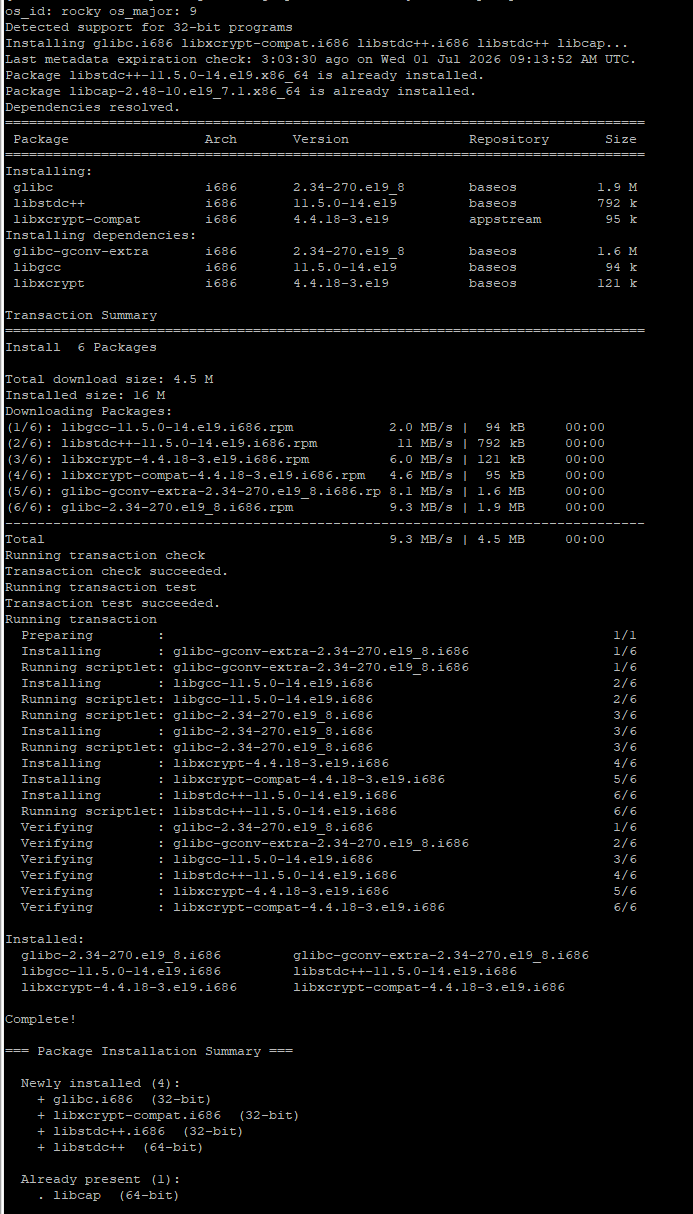

  4. Install the Dependencies with 'setup-deps.sh'
    >./setup-deps.sh

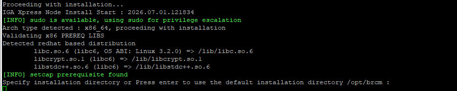

    Deploy IGA Xpress with the install command
    >./install
  5. Either provide custom installation directory or press enter to use default /opt/brcm
  6. Enter username, this will be the owner of the IGX Application.

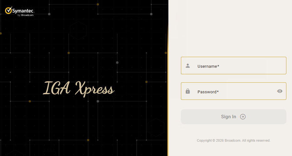

IGA Xpress deployment is now complete and can be accessed at https://<ip_address>:10443 with IGA Xpress admin user username.
If this is a simple single node deployment you are ready to access the IGA Xpress browser interface and begin deploying the Application Services.

  1. Log into IGA Xpress https://<ip_address>:10443 using IGA Xpress admin username.

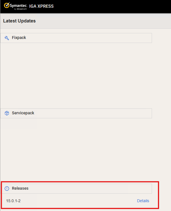

  2. On the Update tab, click the small Configuration gear in the upper right corner.
    Verify access to the remote Channel, or setup a local channel. See the Documentation Configure a Channel for more details

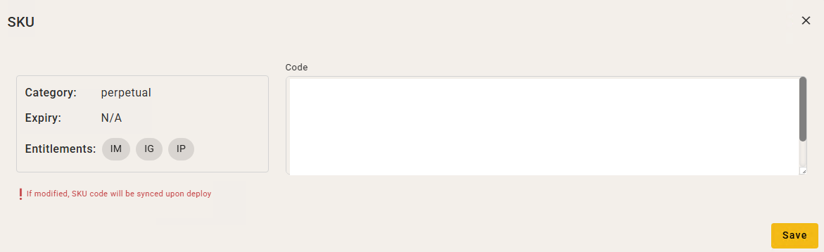

    Click the SKU button and enter your SKU code.
    NOTE:  The SKU code must be set prior to dragging the Application Services circles onto a node.   See the SKU Code documentation for specific details
    Make sure Entitlements on the left side show correct products IM,IP or IG for you.

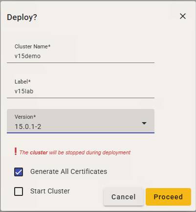

  8. Enter a Name for the Cluster, then from the Version drop down select the Version, Check Generate All Certificates and leave Start Cluster unchecked and click Proceed button.   If you want to use custom certificates or passwords in appserver.p12 and balancer.p12 leave the Generate All Certificates box unchecked. See the documentation on Custom Server Certificates for more details.
    NOTE: only lower case characters, numbers and the - dash symbol are allowed as shown in the warning in the below screenshot:

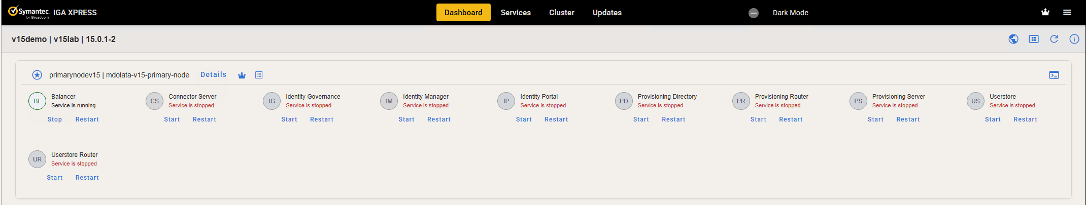

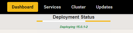

    The deploy will take a few minutes
    and return you to the Dashboard:

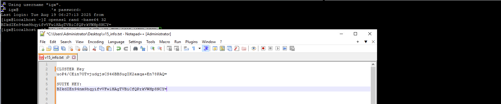

      a.  Open ssh console as igx user, and generate Suite Key and save it in a notepad.
> openssl rand -base64 32
      b. Enter this Suite Key in the Suite section of Services tab of the IGA Xpress console, choose an Encryption Mode (standard or FIPS) and set the Suite Password

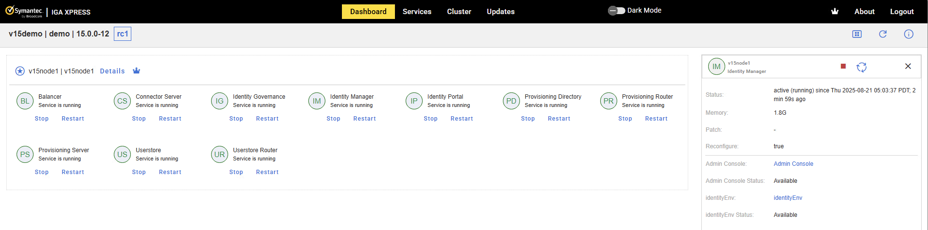

      a.  Log into the IGA Xpress browser interface.  On the cluster tab click the Restart Cluster button.
After the restart is complete you should be ready to start using the various Applications.   You can see Status details about, and direct links to the Application Services by clicking their circles on the dashboard:
Congratulations, You have deployed and complete a basic Identity Suite V15 installation using our new IGA Xpress 2.0 deployment model.
