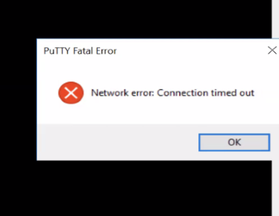

Unable to connect to the ESXi Host using SSH via PuTTY from their local workstation. The connection attempt fails and generates the following error message:
Network error: Connection timed out
  • Host-Side Services Healthy: The host's core management agents (hostd, vpxa) and the SSH daemon (/etc/init.d/SSH) are running normally.
  • Port Binding Active: The ESXi host is actively listening for incoming TCP requests on Port 22 via Telnet.
  • ESXi Firewall Allowed: The built-in security profile for sshServer is explicitly set to permit connections from All source IP addresses. The host is not dropping the packets locally.
  • Alternative Path Successful: An SSH session initiated directly from the vCenter Server Appliance to the ESXi host succeeds, confirming the host accepts connections from the management subnet but drops/times out when accessed via the local client workstation IP.
VMware vSphere ESXi
This is an external network-layer block (such as a hardware firewall rule, router Access Control List, or strict routing policy). This block is preventing traffic on TCP Port 22 from successfully routing between the  local workstation subnet and the ESXi management network subnet.
