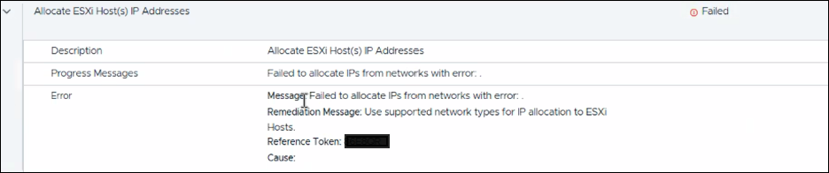

When executing the "Add Host" workflow in VMware Cloud Foundation (VCF), the process consistently fails at the "Allocate ESXi Host IP Addresses" stage.
The task generates the following explicit error:
This failure triggers an immediate automated rollback (UNDO) action. Review of the domainmanager logs indicates that while trying to allocate a vMotion IP address from the Network Pool, the internal Common Services API abruptly rejects the request with an HTTP 400 (Bad Request) error, even when the UI and database indicate sufficient free IP capacity.
