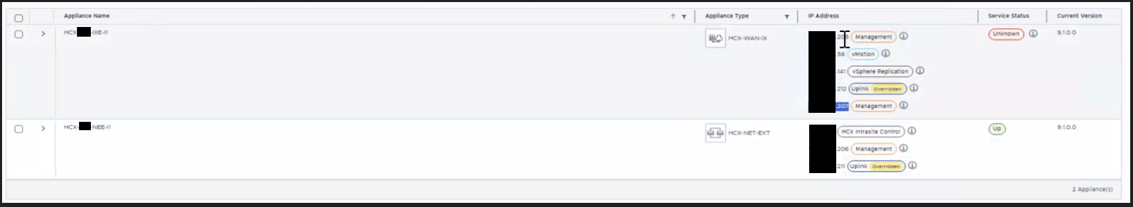

  • Service Mesh Creation failed and the IX Appliance is in Unknown State.
  • IP address assigned dp-management Interface is not reachable from the HXC Manager CLI.
  • Service Mesh creation fails with an "Internal Server Error". The following error is visible in the HCX Manager /common/logs/admin/app.log
    YYYY-MM-DDTHH:MM:SS.sssZ ERROR hcx-app-engine 2489 [hcx@4413 logger="c.v.v.h.s.i.InitiateServiceMeshOperation" thread="InterconnectService_SvcThread-4796" ent="J:d0####79" user="" txid="b7######-####-####-####-##########ed"] processServiceMesh failed, errorCode:null. stacktrace:null, errorMessage:Process Service Mesh failed. Interconnect Service Workflow ConfigureIXEdge failed. Error: LR port creation failed: Failed to create logical router port for management-dp_uplink network of appliance with name HCX-#####-IXE-R1, ID e1######-####-####-####-##########78. Error - Internal Server Error. Cause: Failed to create logical router port for management-dp_uplink network of appliance with name HCX-#####-IXE-R1, ID e1######-####-####-####-##########78. Error - Internal Server Error, LR port creation failed: Failed to create logical router port for management-dp_uplink network of appliance with name HCX-#####-IXE-I1, ID 1e######-####-####-####-##########88. Error - Internal Server Error. Cause: Failed to create logical router port for management-dp_uplink network of appliance with name HCX-#####-IXE-I1, ID 1e######-####-####-####-##########88. Error - Internal Server Error
VCF Operations HCX 9.1
This issue occurs when Network Profiles associated with the Service Mesh are configured with overlapping IP subnet ranges. The overlap prevents the HCX Manager from successfully assigning an IP address to the management-dp_uplink interface of the IX appliance, causing the Logical Router (LR) port creation to fail.
Reconfigure the Network Profiles  to ensure there are no overlapping IP ranges or subnets between different profiles at either the source or destination sites.
