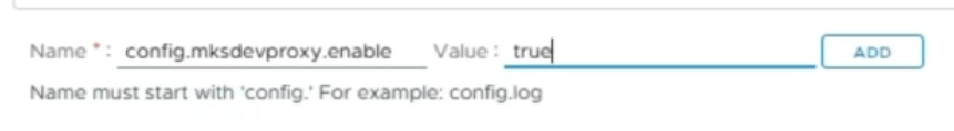

  4. Use the filter (funnel) icon to search for config.mksdevproxy.enable.
  5. If the setting exists and is set to false, change the value to true and save the changes.
  6. If config.mksdevproxy.enable does not exist, go to the bottom of the Advanced Settings page, create the setting named config.mksdevproxy.enable, set its value to true, and add the changes.
  7. Then save the Advanced vCenter Server settings
