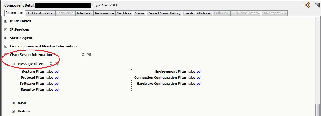

The Cisco Syslog Information -> Message Filters subview of the Cisco device model can be used to filter out unwanted events and alarms from Cisco Syslog traps:
The Cisco Syslog Message Filter OneClick view lets you filter unwanted syslog messages. Filtering syslog messages blocks unwanted alarms or events. The following directory contains eight files that correspond to different filter categories:

If you have other syslog traps that you want filtered out, add the facility to the correct syslog file. After making the change, you need to press the "Update Event Configuration" button on the VNM model in the Information - SpectroSERVER Control area
