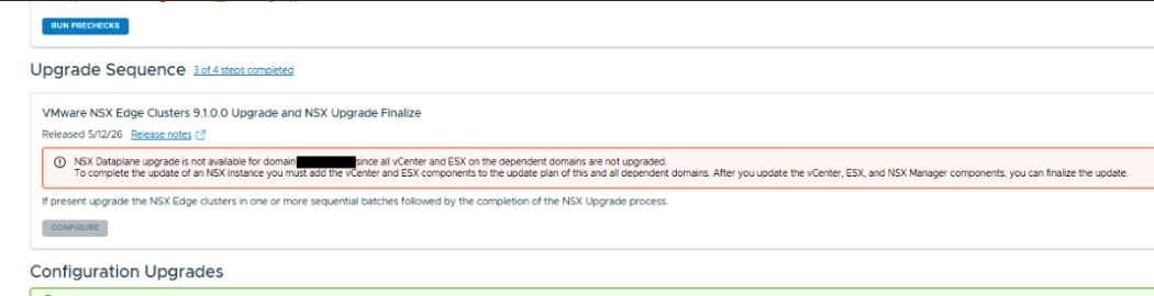

  • Upgrade Sequence displays following message:
VMware NSX Edge Clusters 9.1.0.0 Upgrade and NSX Upgrade Finalize
Released 5/12/26
NSX Dataplane upgrade is not available for domain mgmt since all vCenter and ESX on the dependent domains are not upgraded. To complete the update of an NSX instance you must add the vCenter and ESX components to the update plan of this and all dependent domains. After you update the vCenter, ESX, and NSX Manager components, you can finalize the update.
If present upgrade the NSX Edge clusters in one or more sequential batches followed by the completion of the NSX Upgrade process.
VCF: 9.1
