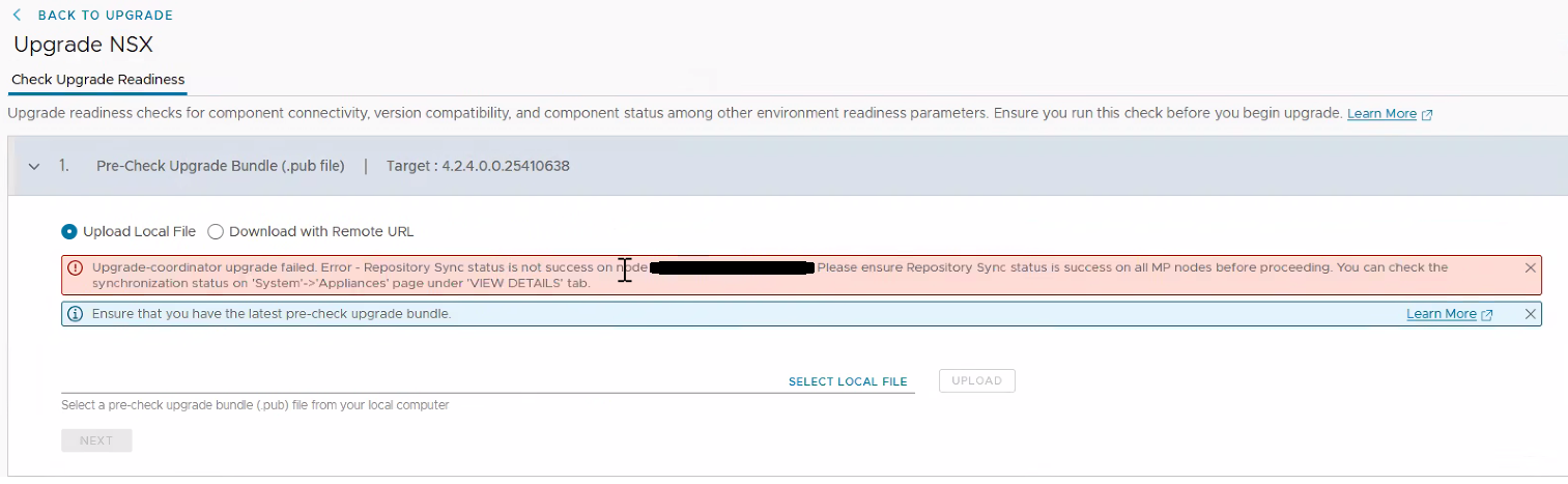

  • While initiating the upgrade precheck, below error is thrown while uploading the .pub file
    Error: upgrade-coordinator upgrade failed. error - repository sync status is not success on node #.#.#.# ,#.#.#.#,#.#.#.#. please ensure repository sync status is sucess on all MP nodes before proceeding.
    You can check the synchronization status on 'System' - 'Appliances' page under view details tab.

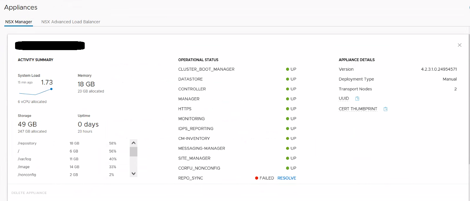

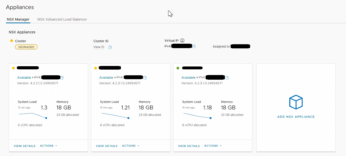

  • Cluster shows DEGRADED as REPO_SYNC service shows  FAILED on one or two of the NSX Manager nodes

  6. Once completed , log in to NSX UI and click the Resolve button next to the Failed status of the REPO_SYNC Service.
  7. After the service status changes to UP , retry uploading the .pub file and proceed with the upgrade.
