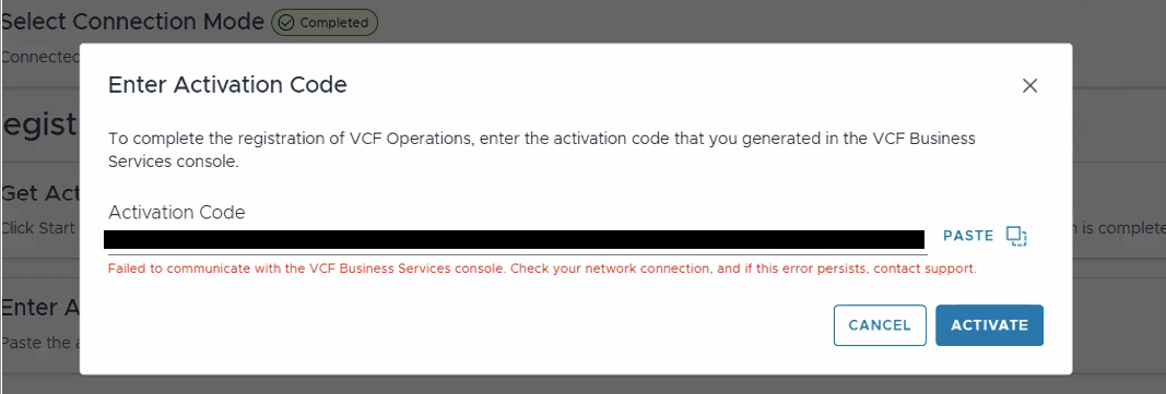

  • After the deployment of VCF Operations 9.1 with a license server, the license server activation fails. The user interface displays the following error message:
    Failed to communicate with the VCF Business Services console. Check your network connection, and if this error persists, contact support
