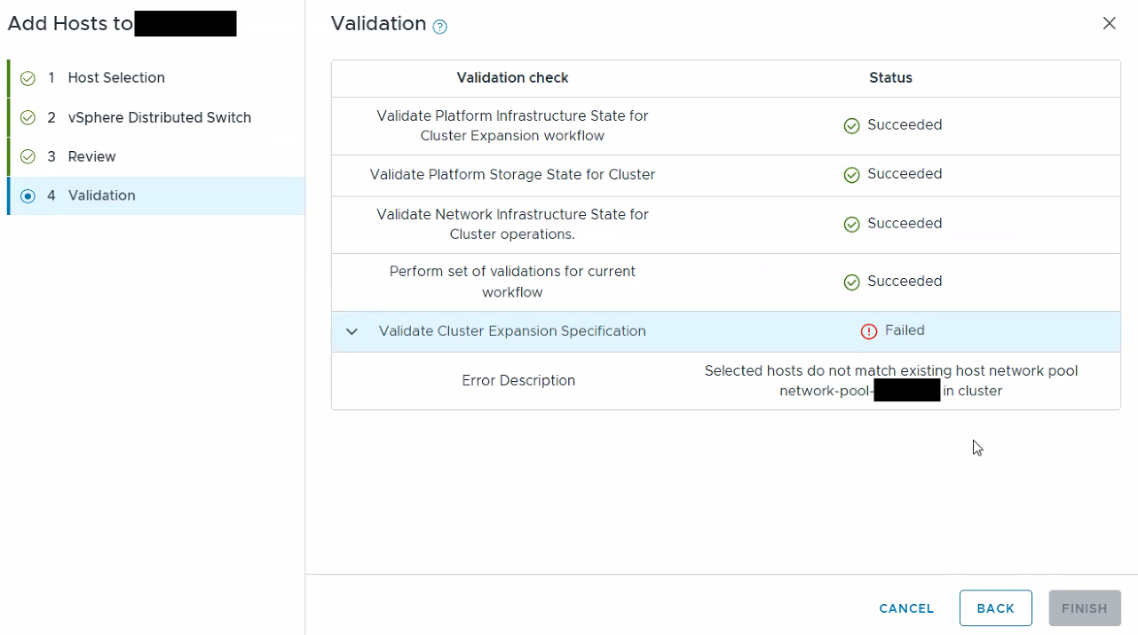

Error: "Selected hosts do not match existing host network pool network-pool-######## in cluster" when adding a vSAN host to a cluster in SDDC Manager

  • Adding a commissioned host to a cluster in SDDC Manager fails during the 'Validate Cluster Expansion Specification' validation check with the following error: "Selected hosts do not match existing host network pool network-pool-######## in cluster"
  • Checking the host_id and the associated network_pool_id in the host_and_network_pool table of the SDDC Manager platform database reveals that the affected host is part of a stale network pool.

The target host remains associated with a stale or incorrect network pool entry within the SDDC Manager database. This configuration mismatch prevents the host from aligning with the active network pool of the destination cluster.
