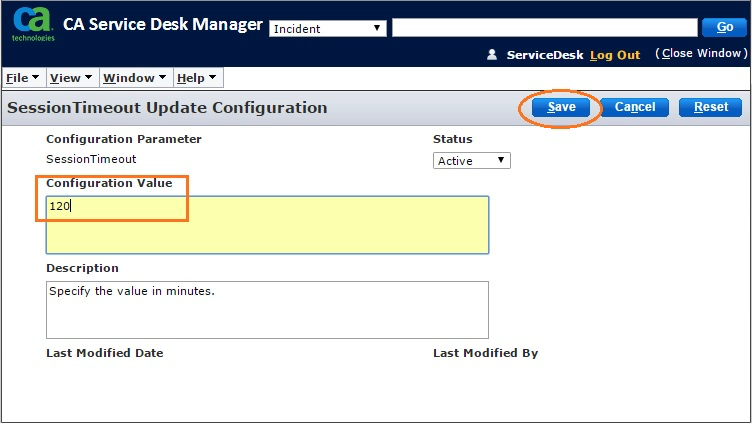

    - Type "SessionTimeout" in "Configuration Key" field
    - Click on the "Search" button
  3. Open the "SessionTimeout" configuration and click on "Edit."
  4. Replace the default Configuration Value "60" with the desired value (in minutes). In this example, type "120" (this will change the session timeout to 2 hours) . Click on "Save" button.
  5. Restart the "CA xFlow Analyst Interface" service for the change to take effect
