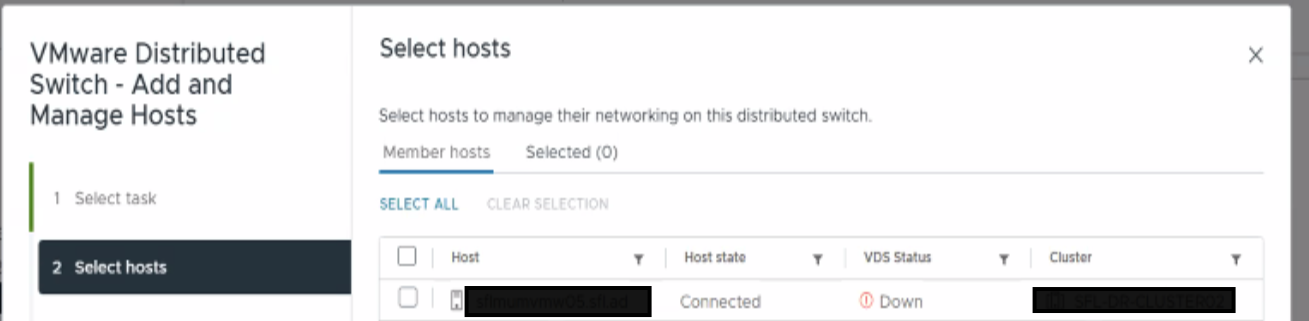

When attempting to add or manage a VMware ESXi host on a Distributed Virtual Switch (DVS), the vSphere Distributed Switch (vDS) status displays as "Down".
This issue prevents proper network configuration, host connectivity through the DVS, and the ability to vMotion virtual machines.
