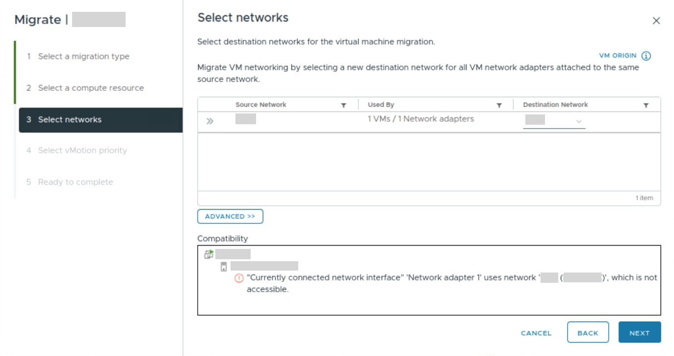

"Current connected network interface" 'Network adapter #' uses network '<PortGroup_Name> (<DVS_Name>)', which is not accessible.[root@<Destination_ESXi>:~] net-dvs -l
switch ## ## ## ## ## ## ## ##-## ## ## ## ## ## ## ## (vswitch)
host properties:
com.vmware.common.host.volatile.overlay.status = red nsxa down, propType = RUNTIME
...VMware NSX
com.vmware.common.host.volatile.overlay.status = red nsxa down, at which point the issue manifests.com.vmware.common.host.volatile.overlay.status remains on the target DVS due to an issue similar to the one described in KB#416818. If this is the case, perform the steps outlined in the Resolution section of KB#416818.Resolve the connectivity issue between the target ESXi host and the NSX Manager.
